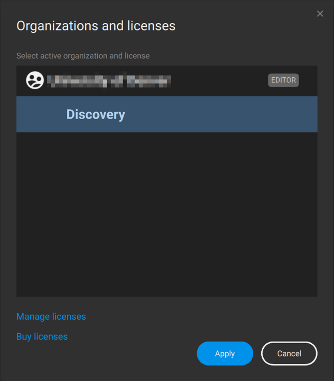

or - The license is not appearing in the Organizations and licenses panel and only Discovery is shown.

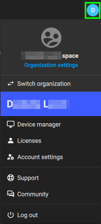

- Click the user button in the top-right corner.

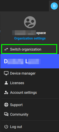

- Click Switch organization.

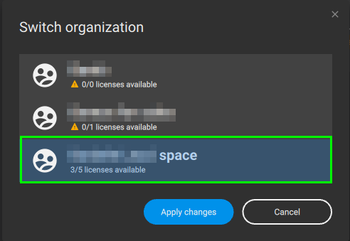

- Check whether the selected organization has an available license.
- If it does not, select an organization with an available PIX4Dmatic license and click Apply changes.
- If the selected organization has a valid PIX4Dmatic license but the message No license available still appears, continue with Solution 2.

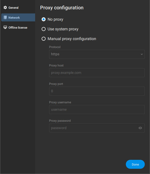

Local networks protected by proxies can cause issues with detecting licenses. A warning No license available is displayed. If a proxy server is used to connect to the Internet, enter the proxy settings as follows:
- Open the Proxy window by clicking Network...
- There are three options to choose from:
- No proxy
- Use System proxy
- Manual proxy configuration
- Ask your system administrator which option to choose from the Protocol drop-down list (http,https,Socks4 Socks5, ). If you do not know choose Use system proxy.
- Enter the proxy Host name and Port number.
- Enter the proxy Username and Password.
- Click Done.
