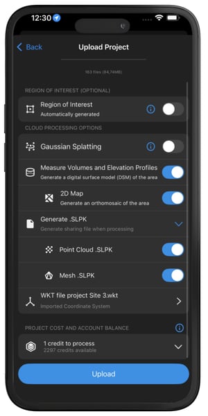

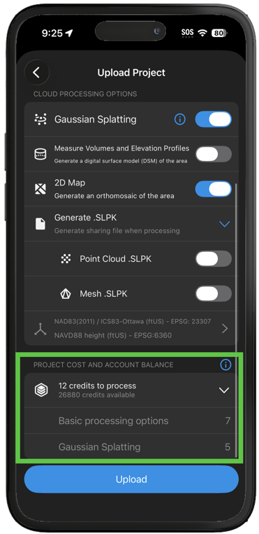

When uploading to PIX4Dcloud, the Project Cost and Account Balance field displays the number of credits needed to process the project along with the credits available.
Note: turning on Gaussian Splatting will consume 5 additional credits regardless of project size.
Uploading a project with sufficient credits
With sufficient credits, tap Upload to process the project. When processing begins, an email is sent. When processing has finished, an email will also be sent.

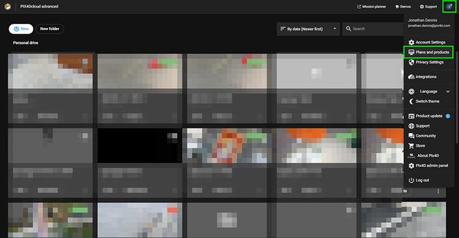

  1. Open and log in to PIX4Dcloud (cloud.pix4d.com).
  2. Click the Account icon (with initial) and select Plans and products from the dropdown menu.

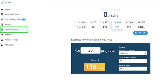

  3. Select Credit transactions from the menu.
  4. Select the appropriate package. A calculator is provided to assist in calculating the required credits.
