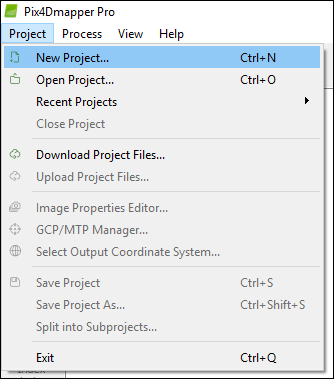

- Start PIX4Dmapper.
- On the Menu bar, click Project > New Project...
- The New Project wizard opens:

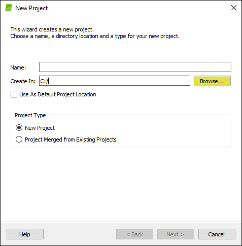

- In Name: type a name for the project.
- (optional) In Create in: click Browse... On the Select Project Location pop-up, navigate to select the folder where the project and results will be stored and click Select Folder.
- (optional) Select the checkbox Use As Default Project Location to save all new projects in the selected folder.
- In Project Type, keep the default option New Project selected.
- Click Next.

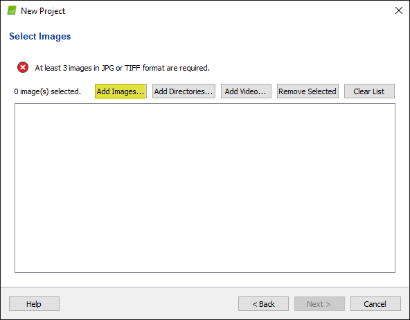

On the Select Images window:
- Click Add Images... to add the images.
- On the Select Images pop-up, navigate to select the folder where the images are stored, select the images to be imported (it is possible to select multiple images), and click Open.
- Click Next.

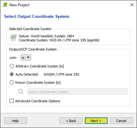

In the Select Output Coordinate System window:
- (Optional) Change the Output / GCP Coordinate System.
- By default, the output and GCP coordinates system will be the same. Thereby, outputs can be shown in the coordinate system of the GCPs.
- By default, the Unit is m (meters).
- If the images have geolocation, by default, Auto detected is selected, displaying the corresponding UTM or NAD83 zone of the images.
- If the images do not have geolocation, by default, Arbitrary Coordinate System is selected.
- Click Next.

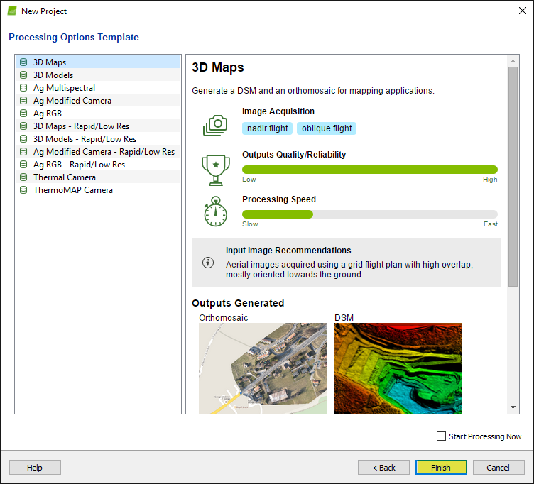

Ιn the Processing Options Template window:
- Select the desired template based on the application and the desired outputs described in the section Processing Options.
- (Optional) Select the box Start Processing Now to automatically start the processing.
- Click Finish to finish the wizard and start the project.
