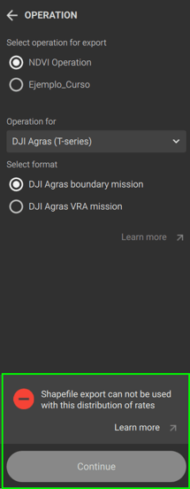

This article explains the limitations when exporting a shapefile as a boundary mission for spraying drones, and the error below is shown: "Shapefile export can not be used with this distribution of rates."
Introduction
A boundary mission exports the prescription as a shapefile. PIX4Dfields disables that export when the rate distribution cannot be stored in the shapefile, and shows this message: "Shapefile export can not be used with this distribution of rates".
The limits below apply whenever that message appears. When the boundary mission is disabled, export the operation as a VRA mission instead.

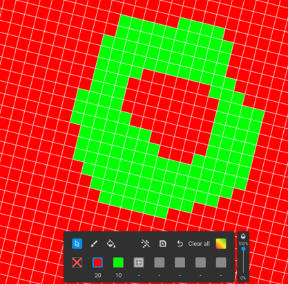

Zone inside zone
It is impossible to export a rate zone that is completely inside another zone as a shapefile for a boundary mission.
In this case, the best solution is to export as Variable Rate mission.

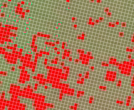

Complex prescriptions
Spot spraying application maps are also incompatible with boundary mission exports. In this case, the best solution is to export as a Variable Rate mission.

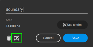

    1. Double-click the boundary layer.
    2. Click the Edit icon.

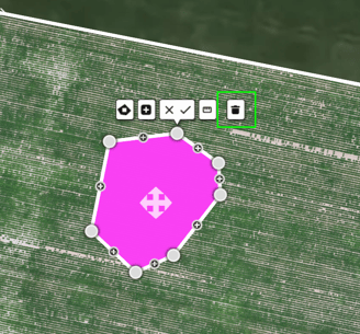

    3. Double-click the hole
    4. Click Delete selected item
      DeleteHole

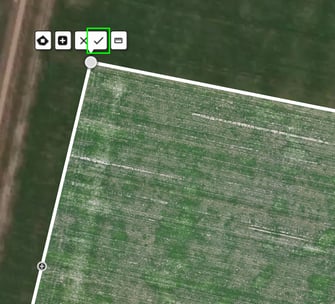

      1. Click Accept.
        ACcept
      2. Create an Obstacle instead.
