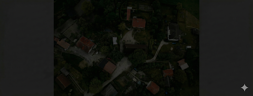

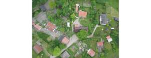

For all use cases, it is not recommended to capture over/under-exposed images since these images do not produce good results.
original_image overexpose_image underexpose image
original image strongly overexposed image strongly underexposed image

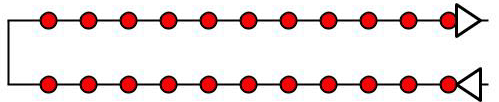

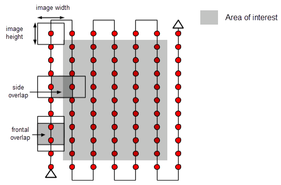

General case
The recommended overlap for most cases is at least 75% frontal overlap (with respect to the flight direction) and at least 60% side overlap (between flying tracks). It is recommended to take the images with a regular grid pattern (Figure 1). The camera should be maintained as much as possible at a constant height over the terrain/object to ensure the desired GSD.
Figure 1. Ideal Image Acquisition Plan - General case.

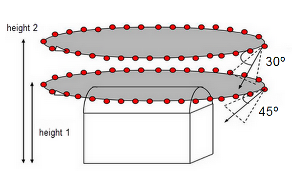

Building reconstruction
Reconstructing 3D buildings requires a specific image acquisition plan (Figure 2):
  • Orient the pitch of your camera so that the majority of the image is filled with the object you want to reconstruct, and objects you do not want to reconstruct comprise the minority of the image. No single camera pitch angle can be applied to all missions.
  • Fly a second and third time around the building, increasing the flight height and decreasing the camera angle with each round.
Note: For more information about oblique imagery: Vertical vs oblique imagery.
  • It is recommended to take one image every 5-10 degrees to ensure enough overlap, depending on the size of the object and its distance to it.
  • The flight height should be increased at most twice between the flights, as different heights lead to different spatial resolutions.
  • PIX4Dcloud generates a high-quality point cloud for oblique images of buildings.
Figure 2. Ideal Image Acquisition Plan - Building.

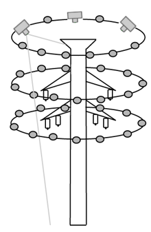

The 3D reconstruction of objects that are tall and slender requires a specific image acquisition plan (Figure 8):
  • Fly close to the structure.
  • Fly several times around the structure at several heights.
  • Images should be taken with high overlap: 90% overlap between images taken at the same height and 60% overlap between images taken at different heights.
  • Everything in the image frame must be in focus, including objects in the background that are outside the project area.
  • Having image geolocation is recommended.

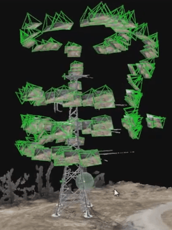

Power Tower
Power Tower reconstructed in the rayCloud
Figure 8. Image Acquisition Plan - Power tower.
Note: For more information on how to map and measure pole and tower structures, see  How to map and measure Pole and Tower Structures.

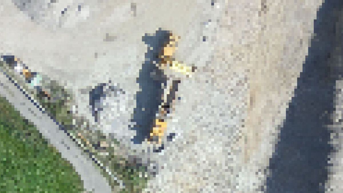

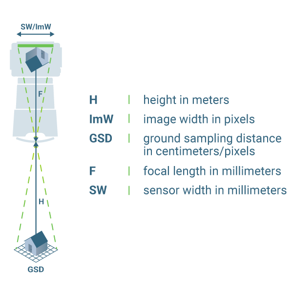

Capture images with an appropriate ground sample distance.
This article explains what the Ground Sampling Distance (GSD) is and how to calculate it.
The Ground Sampling Distance (GSD) is the distance between two consecutive pixel centers measured on the ground. The bigger the value of the image GSD, the lower the spatial resolution of the image and the less visible details.
The GSD is calculated based on:
  • The flight height / the distance from the terrain or object (H).
  • その camera specifications:
    • Image width (ImW).
    • Sensor width (SW).
    • Focal length (F)
Information:
It is important to decide on the GSD value before starting the image acquisition in order to adjust the flight height and the camera specifications to the project requirements. For example, when a detailed reconstruction of the area is needed, we recommend flying closer (low GSD) to the object of interest. On the other hand, when covering large areas that do not need very detailed results, flying higher (high GSD) can greatly reduce the acquisition time and batteries needed as well as to reduce the processing time.
例:
  • A GSD of 5 cm means that one pixel in the image represents linearly 5 cm on the ground (5*5 = 25 square centimeters).
  • A GSD of 30 cm means that one pixel in the image represents linearly 30 cm on the ground (30*30 = 900 square centimeters)
Note: Even when flying at a constant height, the images of a project may not have the same GSD. This is due to terrain elevation differences and changes in the camera angle while shooting. Since the orthomosaic is created using the 3D point cloud and the camera positions, an average GSD will be computed and used.

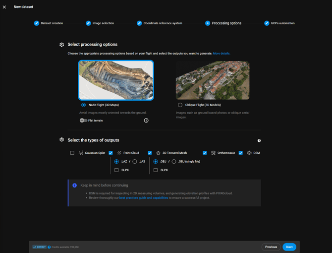

Select the processing options that are appropriate for the dataset.
PIX4Dcloud offers different processing options depending on the type of flight that the user would like to process. The recommended options are listed below:
Type of flight and dataset Recommended processing options
Nadir RGB images Nadir Flight (3D maps)
Oblique RGB images Oblique Flight (3D models)
Terrestrial RGB images Upload from PIX4Dcatch
360 images Not supported
Multispectral images (*) Not supported
RGB images of agricultural fields
Nadir Flight (3D maps) with flat terrain
Thermal images (**) Not supported
(*) Multispectral images are not supported. Processing in PIX4Dmapper or PIX4Dfields is recommended.
(**) Thermal RJPG images are not supported. Only thermal JPG grayscale images are supported but this is not recommended as the results may exhibit radiometric errors, scale problems, and calibration inaccuracies.
Information: PIX4Dcloud alone doesn't support processing RJPEG images.
警告:
  • Selecting the wrong processing option for your flight may lead to bad results.
  • Panorama 360 images are not supported for processing in PIX4Dcloud.
For more information, see New dataset > Processing options - PIX4Dcloud.

PIX4Dcloud offers a default set of optimized options for processing.
  • Nadir Flight (3D maps): It is ideal for aerial RGB images acquired using a grid flight plan with high overlap, mostly oriented towards the ground. Typical applications are quarries, cadasters, etc.
    • Flat terrain: Ideal for RGB aerial images acquired using a grid flight plan with high overlap on flat terrain, for example, agricultural fields.
  • Oblique Flight (3D models): Ideal for any RGB images with a high amount of overlap, such as oblique aerial images (free flight). Application examples are 3D models of buildings, objects, inspection, etc.
Cloud_processing_options
Information:
  • Sometimes, the default parameters may produce wrong results even if the flight is correct and the images are of sufficient quality.
  • If the processing options must be changed, other software packages like PIX4Dmatic can be used instead

PIX4Dcloud uses default parameters for processing.
PIX4Dcloud is a user-friendly web-based software designed for simplicity, eliminating the need for expertise in photogrammetry. It uses a set of default parameters tailored for various flight scenarios. These parameters are not adjustable.
