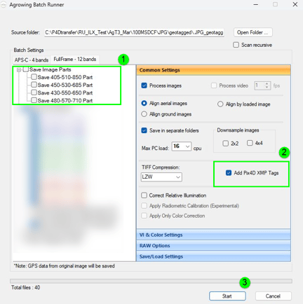

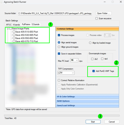

Pre-processing in "Agrowing batch runner"software
When pre-processing the images, make sure to select:
  1. Save image parts
  2. Add Pix4D XMP tags
  3. Start
