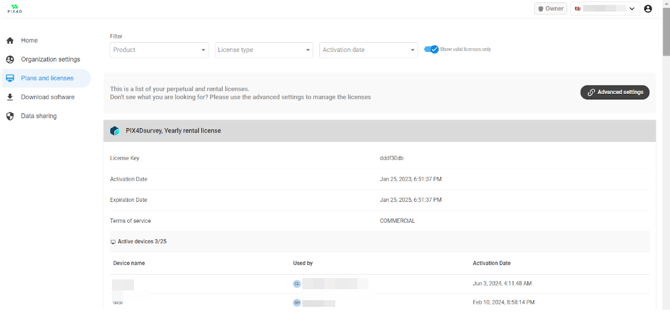

[PIX4Dmatic/PIX4Dsurvey] Where can I check the available seats with my license at any given time?
[PIX4Dfields/PIX4Dreact]How many seats are available to access my license?[PIX4Dfields/PIX4Dreact] Can I free up a seat (deactivate a device) when a colleague is logged in?

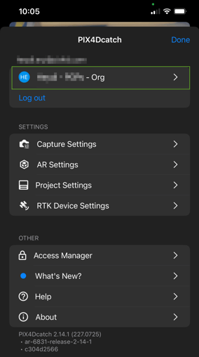

[PIX4Dcatch] How do I know which organization I am currently logged into?

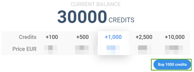

[PIX4Dcloud] How can I buy credits for my Organization?
Only Owners and Managers can buy credits on behalf of the Organization.
  1. Log in to https://account.pix4d.com/home with the Pix4D credentials.
  2. Access the Organization Dashboard.
  3. Click Credit transactions > Credit balance.
  4. Select a credit package.
  5. Click Buy No credits.
    Current balance

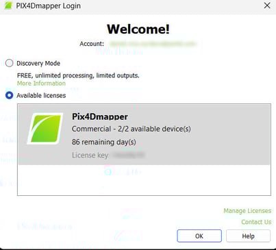

[PIX4Dmapper] How to log in to a PIX4Dmapper license inside an Organization?
A user has to be at least EDITOR to use a PIX4DMapper license associated to an organization.
If the user belongs to more than one organization, once the email and password are filled in PIX4Dmapper, the user will be offered to select any of the licenses that are owned by the default organization.
In order to set the default organization, see this article.
mapper_login
You can also access the Account settings to see the number of PIX4Dmapper licenses and seats available for the Organization.
[PIX4Dmatic/PIX4Dsurvey] How many seats are available to access my license?
The available seats are listed in Organization > Plans and licenses.seat matic
Αlternatively, the available seats are within PIX4Dmatic/PIX4Dsurvey. Click on the Account icon on the top-right corner and then Device Manager.matic organization switcher

[PIX4Dcatch] How do I know which Organization I am currently logged into?
  1. Click the user icon at the top right corner of the app.
  2. Access Account settings, and then you will see your organization.
    Org_PIX4Dcatch_login_default
Note: Under Plans and Licenses, the current subscription and active devices available can be verified.

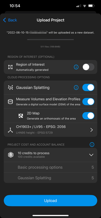

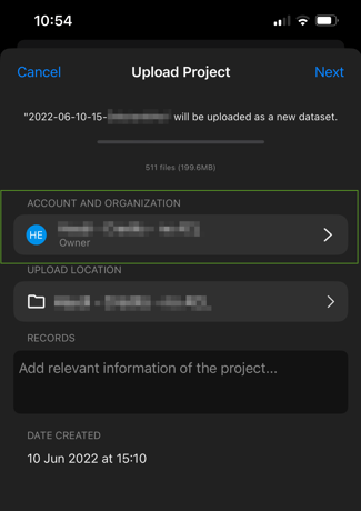

[PIX4Dcatch] Selecting a Different Organization for PIX4Dcloud License from PIX4Dcatch app
Important: To process a dataset under a different Organization than the one where the PIX4Dcloud license is assigned, the user must first be invited to that Organization with a role of Editor or higher. For more information, see PIX4Dcatch within an Organization.
If the PIX4Dcloud and PIX4Dcatch licenses belong to different Organizations, the user must follow the steps below to select the Organization associated with the PIX4Dcloud license when uploading a project from PIX4Dcatch:
  1. Open the project to be uploaded.
  2. Click Upload.
  3. In the Upload Project wizard, under Account and Organization, select the Organization where the PIX4Dcloud license is located.
    Cloud_org_Acc and Org_PIX4Dcatch
  4. Select the desired processing options.
    Upload_cloud_catch
  5. Click Upload.
