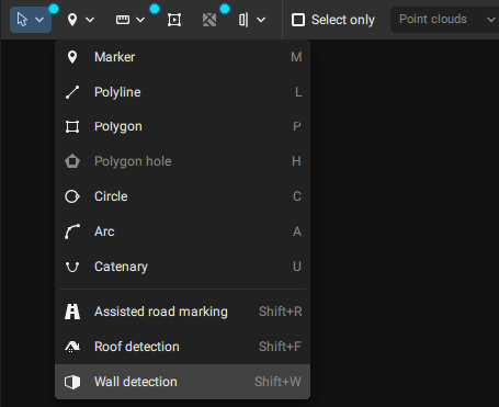

  3. Select the Wall detection tool PIX4Dsurvey wall detection icon from the toolbar.
