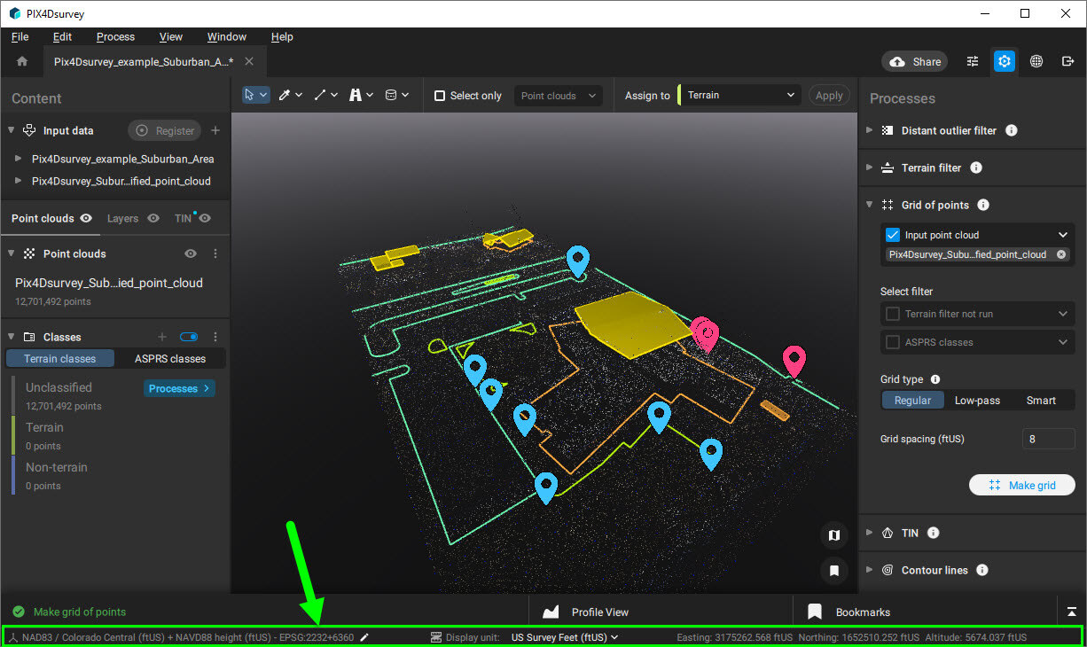

The status bar displays the coordinate reference system of the project, the display unit, and information about the current point position.
The status bar
The status bar is divided into 3 main parts:
  • The coordinate reference system of the project (left)
  • The display unit (center)
  • The pointer position (right)
PIX4Dsurvey status bar
Note: The pointer position appears only when you hover the pointer in the 3D view.
