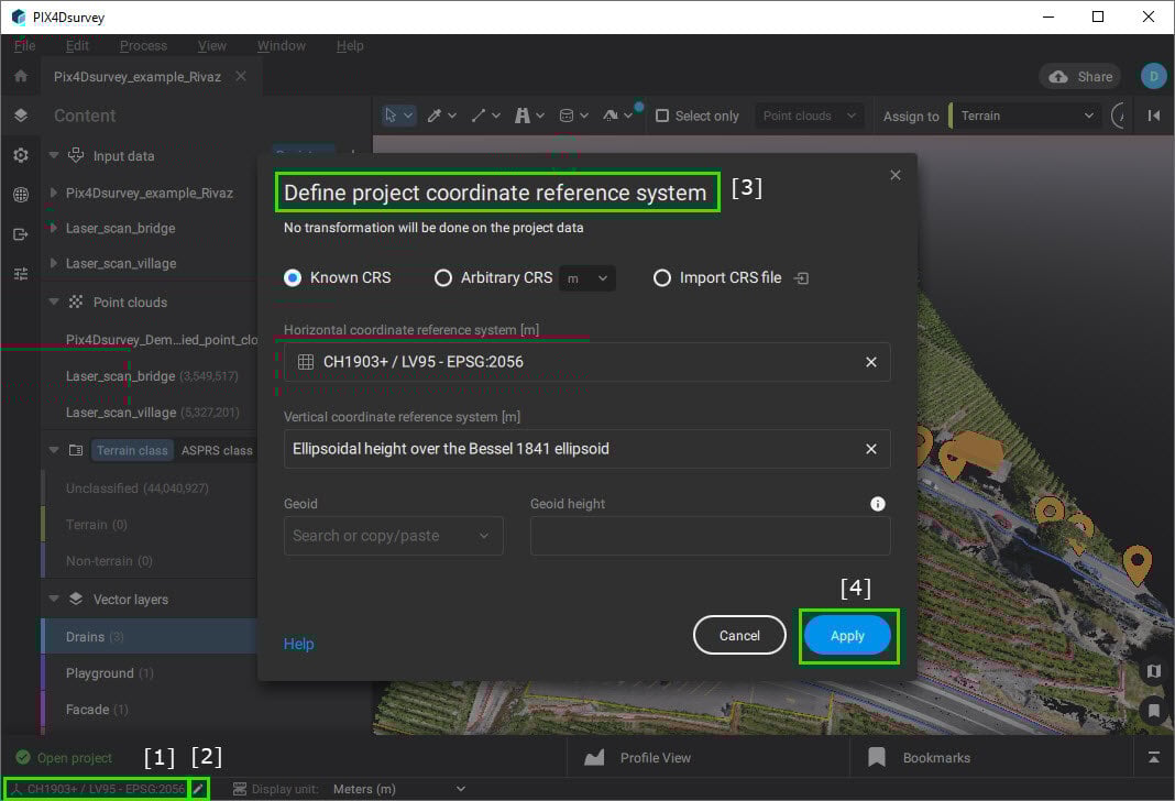

To change the project's coordinate reference system [1] after it is created:
  • Click the Pix4D_edit_icon.jpg icon [2] in the bottom bar.
  • In the Define project coordinate reference system [3] dialog set the:
    • Horizontal coordinate reference system (using the EPSG code is recommended),
    • Vertical coordinate reference system (using the EPSG code is recommended),
    • (Optional) Geoid,
    • (Optional) Geoid height.
  • Click Apply [4].
    PIX4Dsurvey define project CRS
When changing the coordinate reference system, the originally imported data is not transformed and only the coordinate reference system definition changes.
