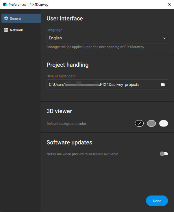

Preferences
Before starting the project right away, we advise taking a look at PIX4Dsurvey's preferences and modifying them if necessary. This might result in a better experience during all future projects.
  1. Access the preferences:
    1. Windows user: Click on the menu Edit > Preferences.
    2. MacOS users: Click on the menu PIX4Dsurvey > Preferences.
  2. In the General tab, select the Language according to your preference (this guide will use the English version).
  3. Choose a Default folder path suitable for most of your projects. This folder will be selected by default at every new project creation. Make sure you have read/write privileges in this folder and that you have enough disk space available. If possible, avoid network drives or cloud-shared folders such as Google Drive, OneDrive, Dropbox, or other.
  4. Click Done. The preferences selected are saved and kept for a future project.

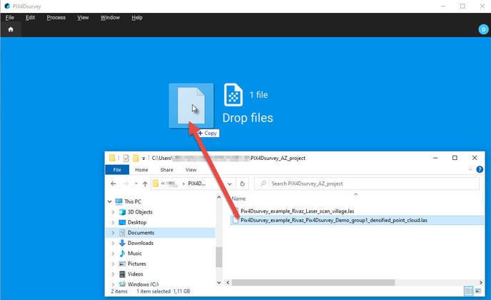

For this exercise, we will use the first method: Drag and drop input files into the home screen.
  1. Make sure you extracted the PIX4Dsurvey_AZ_project.zip compressed file found in the download dataset section.
  2. Open PIX4Dsurvey.
  3. Open the PIX4Dsurvey_AZ_project folder:
    1. Windows users: Open a File explorer window and navigate to the PIX4Dsurvey_AZ_project folder.
    2. MacOS users: Open a finder window and navigate to the PIX4Dsurvey_AZ_project folder.
  4. Drag and drop the Pix4Dsurvey_example_Rivaz_Pix4Dsurvey_Demo_group1_densified_point_cloud.las file from the folder to the PIX4Dsurvey home screen.
    PIX4Dsurvey Drag and Drop

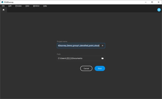

  5. Choose a Project name such as "My first PIX4Dsurvey project". The path will be the one chosen in the preferences section.
    PIX4Dsurvey Project name and path
  6. Click on Start.

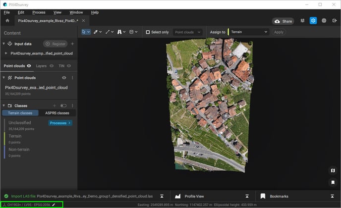

  7. PIX4Dsurvey imports the point cloud LAS file. At the end of the import, the point cloud will be displayed in PIX4Dsurvey. Note on the bottom-left side, PIX4Dsurvey detected the coordinate system of the point cloud automatically: CH1903+ / LV95 - EPSG:2056.
    PIX4Dsurvey Imported point cloud
Tip: The Coordinate Reference System (CRS) is detected automatically by PIX4Dsurvey based on the information written in the point cloud metadata. Additional information about coordinate systems in PIX4Dsurvey can be found in the How to use coordinate systems in PIX4Dsurvey article.

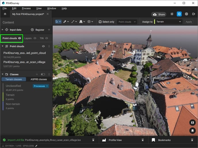

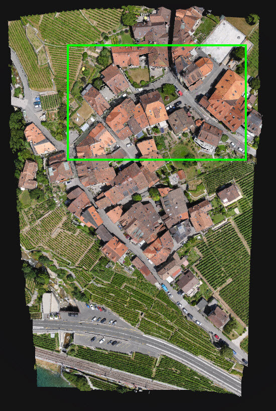

Once both point clouds are loaded into the "My first PIX4Dsurvey project" project, it is possible to turn the visualization on and off for single point clouds or projects.
  1. Navigate to an area in the project where both point clouds are visible.
    PIX4Dsurvey both Point clouds
    1. Left-click to pan the 3D view.
    2. Right-click to rotate the 3D view.
    3. Use the scroll wheel to zoom in and out on the 3D view.
  2. Locate the Point clouds tab in the Content sidebar on the left side of the PIX4Dsurvey window.
    PIX4Dsurvey Point Cloud Tab
  3. (optional) If not already expanded, click on the expand button Expand icon to show both point clouds.
  4. Click on the Hide all point clouds button Hide icon in the Point clouds tab. Both point clouds will disappear from the 3D view.
  5. Click on the Show all point clouds button Show icon. Both point clouds are displayed again in the 3D view.
  6. Hovering with the mouse over the two point cloud names in the Point clouds tab will show the Hide points button Hide icon. Click on this button to hide or show a single point cloud.

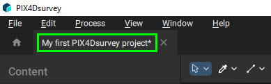

A non-saved project will show an asterisk after the filename. The asterisk will disappear once the project is saved.
PIX4Dsurvey non saved project

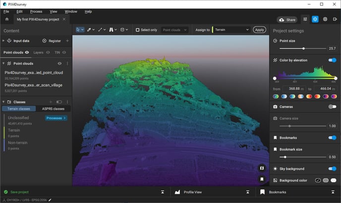

Project settings
Project settings are settings that are applied to the entire project and not to a specific point cloud, layer or vector.
  1. Open the Project settings by clicking on the Project settings icon PIX4Dsurvey project settings, located in the top-right corner of the PIX4Dsurvey window.
  2. Modify the Point Size PIX4Dsurvey point size using the slider. You can see how the point size is changing for both point clouds. Restore the original size.
  3. (optional) To modify the size of a single point cloud, go to the Point clouds tab in the Content sidebar on the left and hover over the names of both point clouds. Click on the Gear icon PIX4Dsurvey point cloud properties to enable the point cloud options. A slider will appear where it is possible to change the point size for that specific point cloud. The Point size slider will overwrite changes in the point cloud options.
  4. Another helpful setting in the Project setting is the Color by elevation PIX4Dsurvey color by elevation. This can be helpful in identifying changes in elevation in the profile. Turn on the toggle Toggle on and eventually choose a preferred color scale. All the points will be assigned to a color depending on their elevation.
  5. Turn off the slider Toggle off .

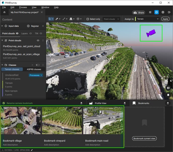

Create bookmarks

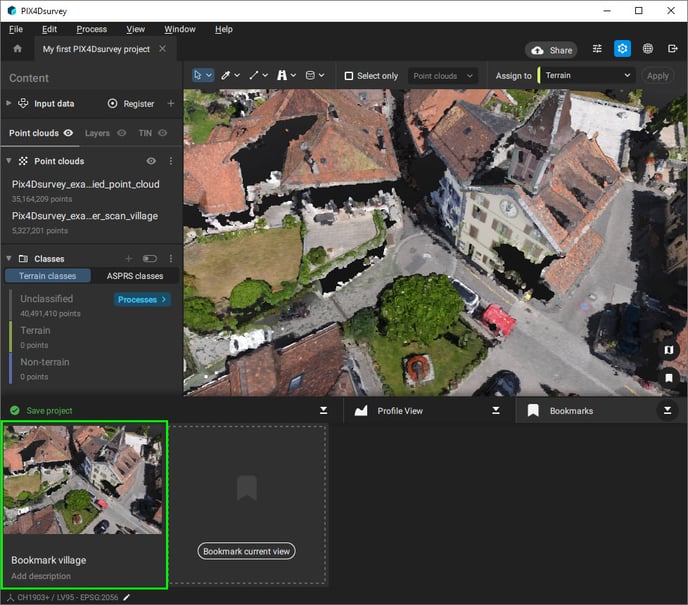

Bookmarks allow saving a particular 3D location and camera orientation of the current view. This feature can be useful in many contexts when there is a need for a later revisit or to show particular areas. We will use this feature to inspect the result of the processing leading to a TIN and contour lines.
  1. Open the Bookmarks tab bookmarks tab in the status center using the expand button Expand.png.
  2. Bookmark of the village:
    1. Navigate into the main square, making sure that both roads and buildings are visible.
    2. Click on PIX4Dsurvey bookmark current view.
    3. Click on the "Camera bookmark 1" text in the newly created bookmark and rename it to Bookmark village. Press Enter on the keyboard.
      PIX4Dsurvey bookmark village
  3. Bookmark of the vineyard
    1. Navigate to a vineyard and move the 3D view so that you can clearly see the plants
    3. Click on the "Camera bookmark 1" text in the newly created bookmark and rename it to Bookmark vineyard. Press Enter on the keyboard.
  4. Bookmark of the main road
    1. Navigate to the main road and move the 3D view so that you can clearly see the parking near the bridge.
    3. Click on the "Camera bookmark 1" text in the newly created bookmark and rename it to Bookmark main road. Press Enter on the keyboard.

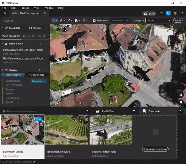

  5. Continue navigating in the 3D view. You will notice that a purple camera was created in the 3D position of the view for every bookmark.
    PIX4Dsurvey bookmark camera in the 3D view
  6. Click on PIX4Dsurvey bookmark visit button to move the view to the one assigned when each bookmark was created.
    PIX4Dsurvey Bookmarks navigate video
  7. Collapse the Bookmarks tab using the collapse button collapse icon.
  8. Save the project with Ctrl + s (Windows) or ⌘ + s (macOS).

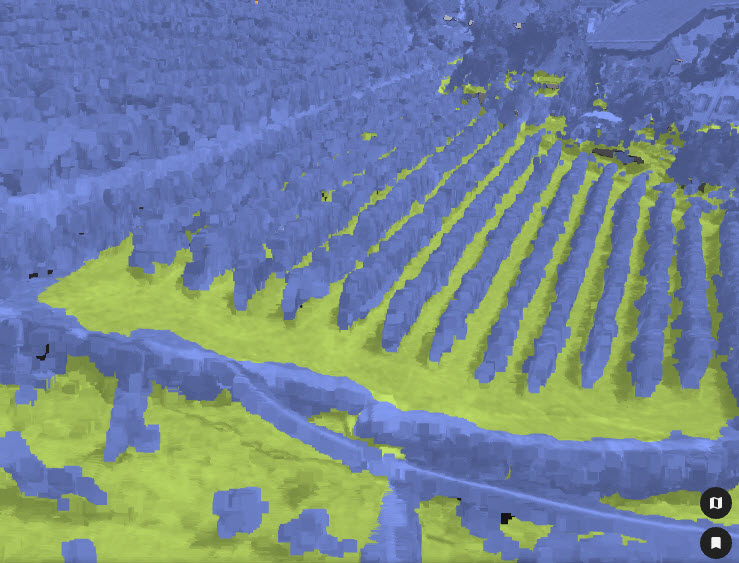

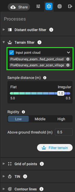

The Terrain filter process classifies selected input point clouds into terrain and non-terrain based on the selected processing values. These classes will then be used in future processing steps, for example, to create a grid of points only from the terrain class.
  1. Click Process PIX4Dsurvey processing icon and expand Expand icon the Terrain filter Pix4Dsurvey terrain filter.
  2. Make sure that both point clouds are selected as Input point cloud
    PIX4Dsurvey input point clouds for the terrain filter
  3. Click on Pix4Dsurvey terrain filter icon Filter terrain

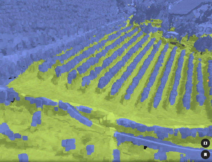

The point cloud in the project has turned into two colors: Green for points belonging to the Terrain group and purple for points belonging to the Non-terrain group. It is possible to re-enable the RGB values for one or both groups by hovering over the Terrain or Non-terrain classes in the Content sidebar on the left and click the Show class in RGB PIX4Dsurvey RGB icon button. To show the class color again, click on Show class in monochrome PIX4Dsurvey Monochrome icon.
PIX4Dsurvey classes
Now it is possible to use the bookmarks created previously to assess the quality of the classification.
  2. Click PIX4Dsurvey bookmark visit icon on every different bookmark. The 3D view will change and will show the same areas saved in the previous chapter.
  3. Visit the Bookmark vineyard and take a look at the classification.
  4. In the Terrain filter processing panel, change the Above ground threshold (m) to 1m.
  5. Run the Terrain filter again.
  6. Verify how the change in the Above ground threshold (m) changed the result.
  7. Visit the other bookmarks to see the effects in changing the Above ground threshold (m) value.
  8. Change the Above ground threshold (m) back to 0.5m and run the Terrain filter again.
PIX4Dsurvey terrain filter 1m
PIX4Dsurvey terrain filter 05m
Tip: Additional information about the Terrain filter in PIX4Dsurvey can be found in the Terrain filter - PIX4Dsurvey article.

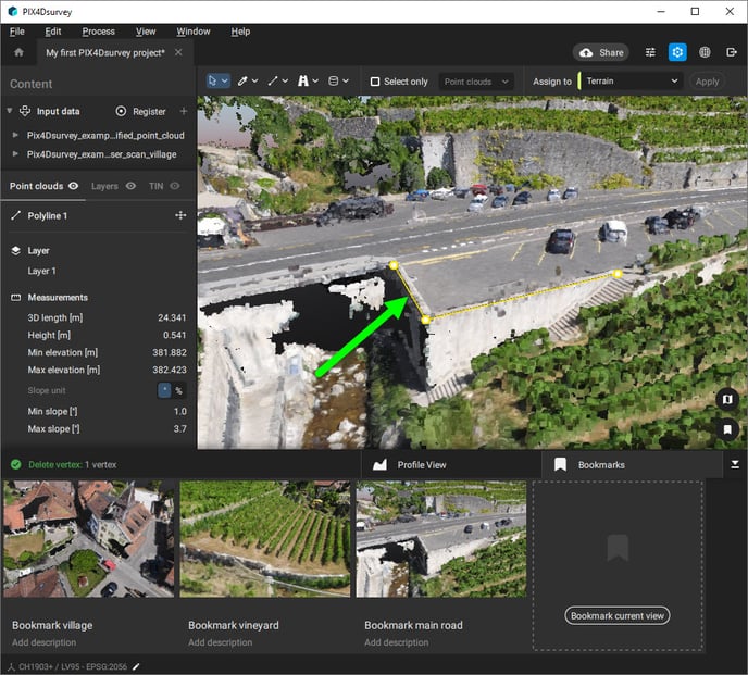

  1. Click PIX4Dsurvey bookmark visit button on the Bookmark main road to move the 3D view to this bookmark.
  2. Enable the RGB view for the point cloud classes using the PIX4Dsurvey RGB icon button in the classes tab of the Content sidebar.
  3. Select the Polyline PIX4Dsurvey Polyline icon tool.
    PIX4Dsurvey polyline tool
  4. Vectorize the polyline using the left mouse button along the border of the parking.
    Polyline drawn at the border of the parking

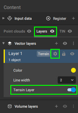

  5. The polyline is found in the Layers tab of the Content sidebar. Click on the gear icon PIX4Dsurvey gear icon and ensure that the Terrain Layer is enabled Toggle on icon.
    PIX4Dsurvey layers tab

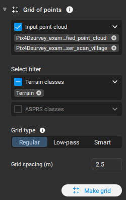

Grid of points
The Grid of points tool helps to automate the creation of spot elevations and allows for drastic simplification of the number of point cloud points. No new points are created; only existing points from the input data are used. It is possible to use the filter in order to take into account only points from a specific point cloud, from a specific class, or a combination of both choices.
  1. Click Process PIX4Dsurvey processing icon and expand Expand icon the Grid of points PIX4Dsurvey Grid of points icon.
  2. Make sure both point clouds are selected in the Input point cloud and that only the Terrain class is selected in the filter.
    PIX4Dsurvey grid of points settings
  3. Keep the Regular grid type selected. Visit the Grid of points - PIX4Dsurvey article to learn more about the other grid types. Keep the Grid spacing (m) 2.5.
  4. Click on PIX4Dsurvey Grid of points icon Make grid.
This will create a grid of points with 2.5m spacing based on the Terrain points in both input point clouds. The grid of points are located in the TIN tab in the Content sidebar.
PIX4Dsurvey grid of points in content sidebar
Tip: Additional information about the Grid of points in PIX4Dsurvey can be found in the Grid of points - PIX4Dsurvey article.

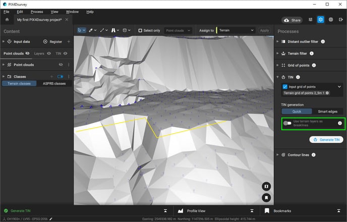

TIN
The TIN process creates a seamless set of triangles representing a surface.

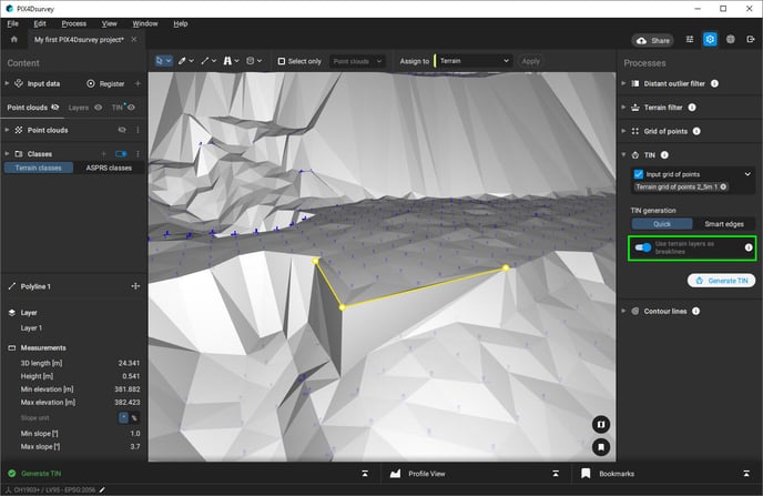

  1. Click Process PIX4Dsurvey processing icon and expand Polygon_2x.png the TIN PIX4Dsurvey TIN icon.
  2. Make sure the grid of points created previously is selected as input.
  3. Disable Use terrain layer as breaklines Toggle off icon.
  4. Click on PIX4Dsurvey TIN icon Generate TIN.
Only the points of the grid are considered for the creation of the TIN, therefore the border of the parking is not well modeled. Disable all the point clouds with the Hide all point cloudsHide all point clouds icon icon in the Content sidebar for better visibility of the TIN.
PIX4Dsurvey point clouds hide all layers button
PIX4Dsurvey TIN use terrain layer as breaklines disabled
  1. If needed, click Process PIX4Dsurvey processing icon and expand Polygon_2x.png the TIN PIX4Dsurvey TIN icon.
  2. Enable Use terrain layer as breaklines Toggle on icon.
  3. Click on PIX4Dsurvey TIN icon Generate TIN.
Now both the points of the grid and the terrain polygon were taken into account and the TIN reflects reality better.
PIX4Dsurvey TIN use terrain layer as breaklines enabled
Tip: Additional information about the TIN in PIX4Dsurvey can be found in the TIN - PIX4Dsurvey article.

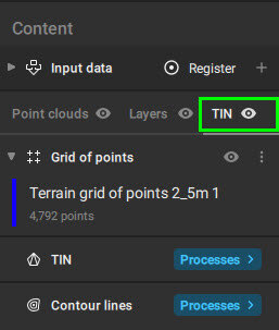

The contour lines are located in the TIN tab in the Content tab.
PIX4Dsurvey Contour Lines content sidebar
