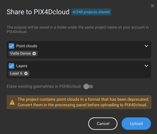

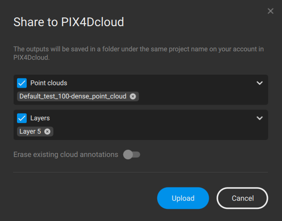

  1. Select Share to PIX4Dcloud... from the File menu or click on the Share button Share To Cloud button, found at the top-right corner of the PIX4Dsurvey window.
  2. Select the layer groups for upload to PIX4Dcloud. Groups available for upload are: point clouds and layers. Within each group, it is possible to select specific layers. An entire group can be enabled/disabled if necessary using the checkbox Checkbox.

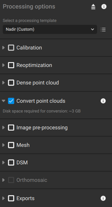

  3. Point cloud file format and Share to PIX4Dcloud for PIX4Dmatic projects
    From version 1.67.0, PIX4Dmatic supports a new format for the point cloud (gLTF), making it easier to use the Share to PIX4Dcloud for larger projects.
    • For projects created using an older version of PIX4Dmatic, a warning message is displayed to convert the point cloud to the new format before using the Share to PIX4Dcloud.
    To convert the point cloud:
    • Open the PIX4Dmatic project.
    • Go to the Processing panel.
    • Check the Convert point clouds step.
    • Click Start.
  4. [Optional] Enable Erase existing cloud annotations to replace the geometries that were already uploaded (if applicable).
    Important: All the point clouds in a project are merged into a single point cloud for the upload. The newly uploaded point cloud will always replace the previous one.

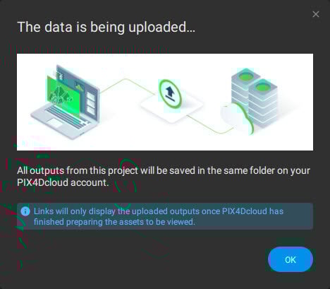

  5. Click Upload. The upload will start, and you can read Share to PIX4Dcloud in the status bar. If you click OK, the data will continue being uploaded, but the Share to PIX4Dcloud tool must be opened again to retrieve the sharing links.
    PIX4Dsurvey share to PIX4Dcloud upload

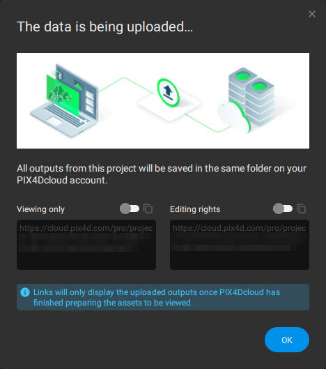

  6. After a successful upload, if the upload pop-up was not closed, the PIX4Dcloud project links are displayed. To enable the links, turn on the switch Toggle switch on. Enabled sharing links can be copied by selecting the URL in the text field and the Ctrl+C or ⌘ +C keyboard combination or the copy button copy.

    Tip: The validity of a sharing link can be revoked by opening File > Share to PIX4Dcloud and turning off the toggle(s) Toggle switch off.

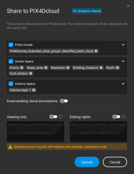

    Tip: If a project was already uploaded, or if the upload window was closed during the upload, it is possible to retrieve the sharing links by opening the Share to PIX4Dcloud tool again. The links will appear at the bottom part of the window. It is possible to enable or disable them using the toggle switch . Enabled sharing links can be copied by selecting the URL in the text field and the Ctrl+C or ⌘ +C keyboard combination or the copy button copy.
    PIX4Dsurvey share to PIX4Dcloud links
