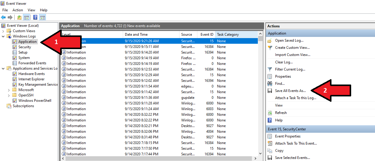

Additionally, it may be helpful to provide the Windows event log. To generate this file:
  1. Start PIX4Dmapper.
  2. Trigger the issue.
  3. From the Windows search field, open Windows Event Viewer.
  4. On the left panel, select Windows Logs > Application.
  5. On the right panel, click Save All Events As...
  6. Save the file as .evtx.
