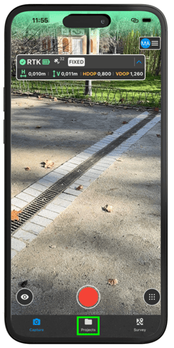

  1. Open PIX4Dcatch.
  2. On the Home screen, tap the projects folder and select the project.

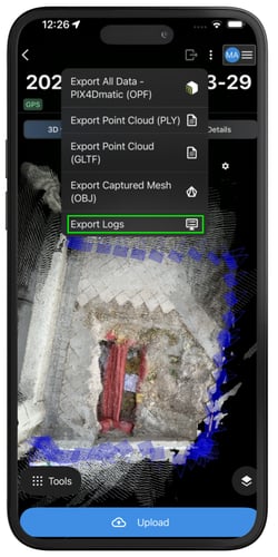

  3. Open the desired project.
  4. Tap the export icon  (located at the top of the screen).
  5. Select Export logs log
  6. Choose the export method (e.g email, cloud storage, phone storage).
  7. A .zip file containing the project folder will be generated.
