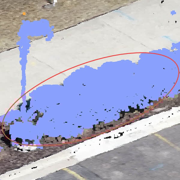

After the point cloud is automatically classified as terrain and non-terrain, assess the accuracy of the classification.
Inspect the quality of the results
The Terrain filter implemented in PIX4Dsurvey does not provide optimal results for all types of projects, therefore the automatic classification may need to be corrected.
The 3D view can be used to inspect the results.

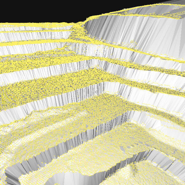

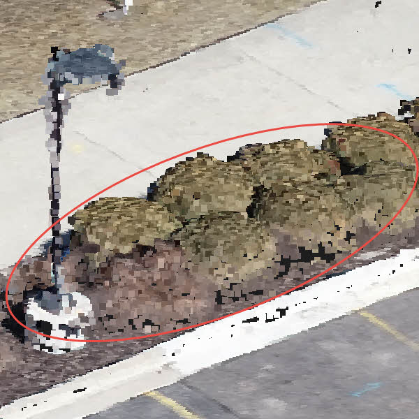

Original point cloud.

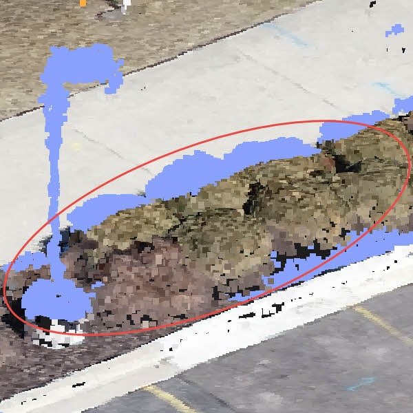

Classified point cloud - default setting. Note that some points are wrongly classified.
Classified point cloud - Sample distance increased to maximum. Bushes were properly detected as non-terrain.
If points that are not correctly classified are detected, rerun the Terrain filter with different processing options or classify points manually.

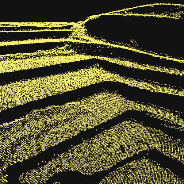

Generate a grid of points
The Grid of points tool helps to automate the creation of spot elevations and allows for drastic simplification of the number of points.
Two types are available:
  • The Regular grid is generated based on the selected sampling distance between points.
  • The Smart grid creates points only where changes in terrain elevation occur.
For more information see Grid of points article.

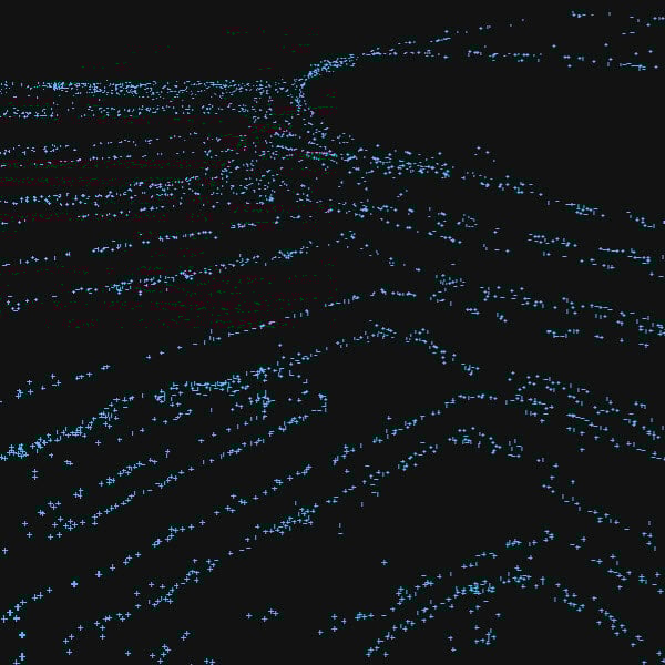

After the point cloud is simplified it only represents significant changes in elevation.

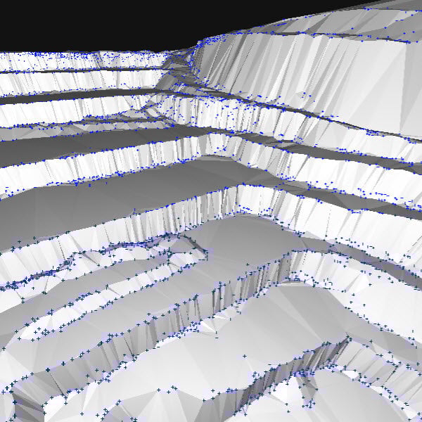

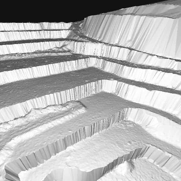

Generate a TIN surface
The TIN surface can be derived from the grid of points and breaklines.
One generates a TIN surface to have a lightweight and continuous representation of the terrain. This can be done by deriving the TIN surface from the grid of points and breaklines.

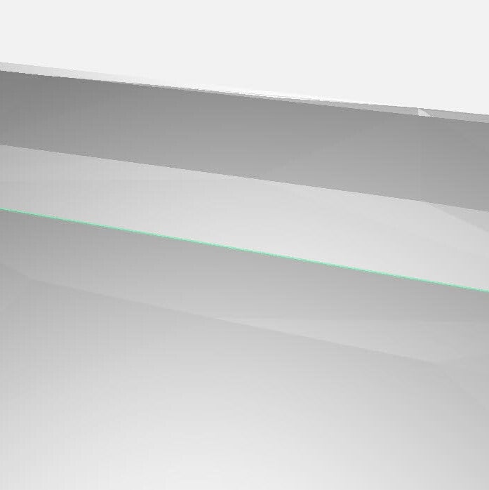

(Optional) Add breaklines for TIN surface generation
The grid of points in PIX4Dsurvey does not provide optimal results for all types of projects, therefore breaklines may be necessary.
Three methods are available:
After objects are vectorized and labeled as a Terrain Layer, they can be used as constraints for the TIN generation.

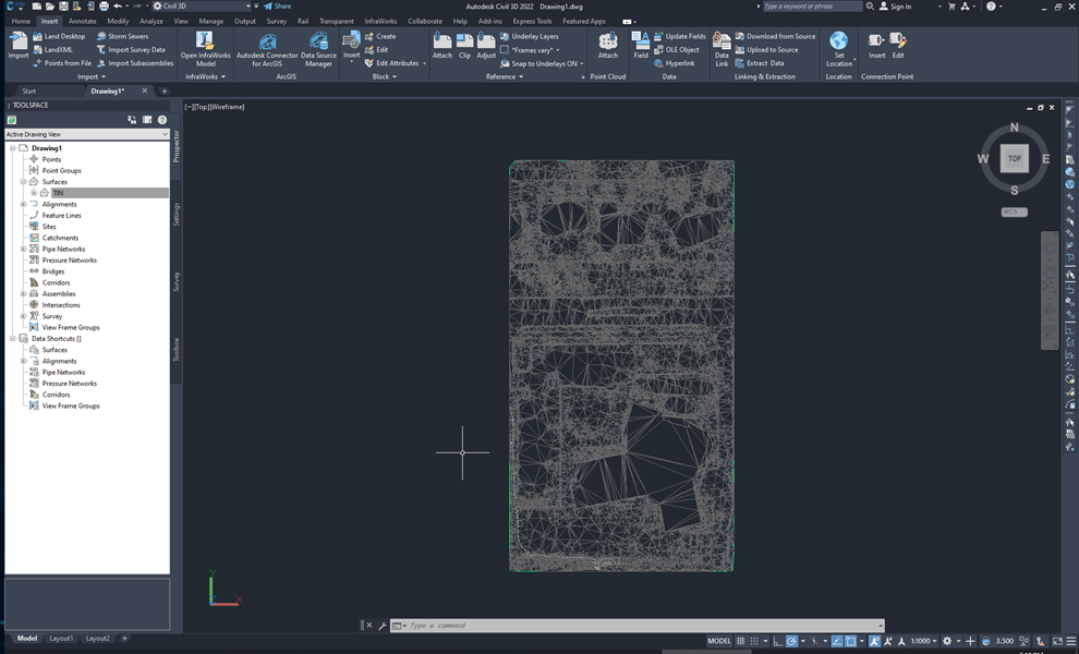

To export the generated TIN surface to a third-party tool, such as a CAD or GIS software., the TIN can be exported in the LandXML file format or in the raster GeoTIFF format.
After the generated LandXML file or GeoTIFF file is exported, it can be imported into a third-party software.
