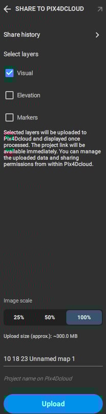

  1. Select Export from the right corner of the top bar.
  2. Click on the share__1_.png Share option to open the Upload to PIX4Dcloud menu.
  3. Select the layers, such as the orthomosaic (Visual), the surface model (Elevation), and annotations (Markers), to Upload to PIX4Dcloud.
    UploadToPix4Dcloud
  4. Define the output size of the layers by selecting between 25%, 50%, or 100% image scale output. 100% maintains full resolution, while a smaller image scale results in a smaller file size and a faster upload to PIX4Dcloud.
  5. [Optional] The name of the project is predefined by the name of the PIX4Dreact desktop project. The name can be modified before uploading.
  6. Click Continue.

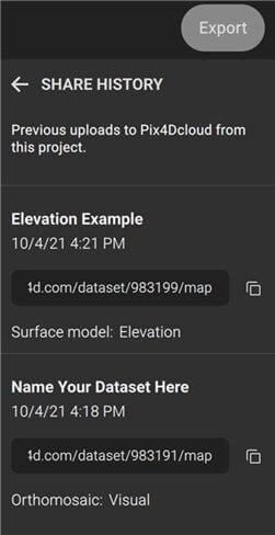

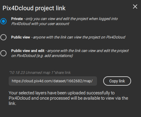

    After a successful upload, the PIX4Dcloud project link is displayed in a pop-up window.
  10. Click on Show PIX4Dcloud projects to view all previous PIX4Dcloud projects.

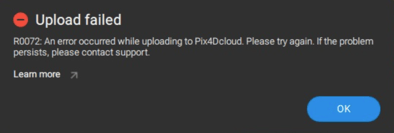

Error R0072
Error R0072 can happen due to several reasons.
  • Only the Owner and Manager of the organization are able to use the feature. For more information: Organization management
  • Users who can create projects in PIX4Dcloud can share from PIX4Dreact. With organization access control, some users can create projects only in specific folders and not at the organization root. In that case, select an allowed folder. For more information: Organization management.
  • Big files that require a higher connection quality to upload. Try reducing the Image Scale:
  • Most of the cases are solved by connecting to the internet through an Ethernet cable. This will reduce micro-disconnections and will help PIX4Dreact finish the uploading.
  • Licenses issue: Make sure that the limits mentioned above are not reached.
