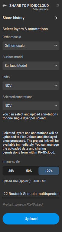

  4. Select the layers, such as:
    1. Orthomosaic (Visual).
    2. Surface model (Elevation).
    3. Index maps.
    4. Annotations:
      - If the selected annotation contains a hole, a message will be displayed: "The selected annotations contain at least one hole." Annotations will be simplified automatically, holes will be removed, and multi-polygons will be separate annotations.
      - Geotagged images associated with the annotations are uploaded to PIX4Dcloud. If multiple images are associated with the annotations, only one image is uploaded.
      UploadToPix4dcloud
  5. Define the output size of the layers by selecting between 25%, 50%, or 100% image scale output. 100% maintains full resolution, while a smaller image scale results in smaller file size and a faster upload to PIX4Dcloud.
  6. [Optional] The name of the upload to PIX4Dcloud project is predefined by the name of the PIX4Dfields desktop project. The name can be modified before uploading.
  7. Click Upload.

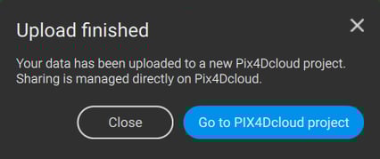

    uploadFinished_FieldsMessage
  8. Click Go to PIX4Dcloud project.

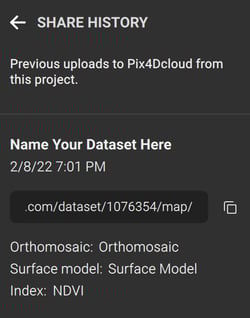

  10. Click Show PIX4Dcloud projects to view previously uploaded projects to PIX4Dcloud.

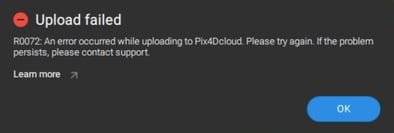

Error R0072
Error 0072 can happen due to several reasons.
  • Big files that require higher connection quality to upload. Try reducing the Image Scale:
  • Most cases are solved by connecting to the internet through an Ethernet cable. This will reduce micro-disconnections and will help PIX4Dfields finish the uploading.
  • Licenses issue: Make sure that the limits mentioned above are not reached.
  • For Mac users: ensure there's no system process called "webfilterproxyd" limiting the connection.
