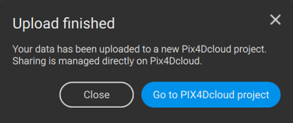

    uploadFinished_FieldsMessage
  9. Click Go to PIX4Dcloud project.

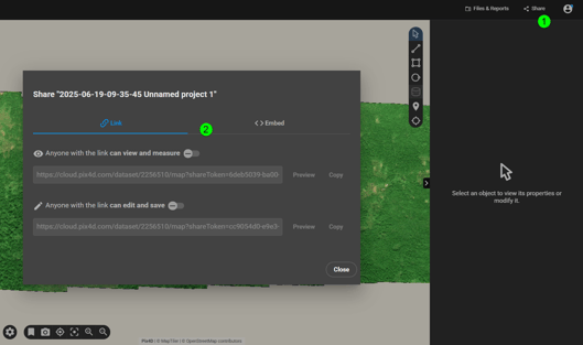

  10. Changes to the uploadable links can be made from within PIX4Dcloud.
    Click share.png Share from the top-right menu bar:
    EditingLink
    1. Enable Anyone with the link can view and measure. The collaborators with this link, while the link is enabled, can:
      • Open a dataset as anonymous users.
      • Measure and perform analysis using the 2D/3D tools and annotations.
      • Change the properties of each layer (visibility, opacity, background color, etc..)
      • After a page refresh, the changes will be discarded.
    2. Enable Anyone with the link can edit and save.
      • Change the properties of each layer (visibility, opacity, background color, etc..).
      • After a page refresh, the measurements and the changes will remain saved.
