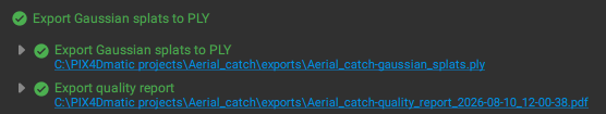

Note: Starting with PIX4Dmatic version 2.9, the Status Center includes direct links for opening exports or navigating to their destination folder.
