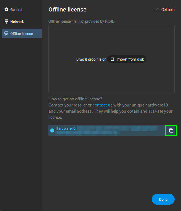

It is possible to request an offline license in order to use PIX4Dmatic or PIX4Dsurvey on a device that is not connected to the internet. To gain access to this license, please follow these instructions:
  1. Open PIX4Dmatic or PIX4Dsurvey on the device you are planning to use offline.
  2. Open the Preferences using the Menu Edit > Preferences (PIX4Dmatic or PIX4Dsurvey).
  3. Open the Offline license tab.
  4. Copy the Hardware ID in the clipboard using the copy button PIX4Dsurvey PIX4Dmatic copy button found near the Hardware ID in the blue box.
    Important: It is necessary to open the software and copy the Hardware ID while using the device that will be used for offline use. The license will be valid only on that specific device.
  5. Contact your reseller or contact us, providing the Hardware ID.
  6. The salesperson will contact you to confirm the product type.
    Information: For perpetual licenses, the offline license file will be version locked. For subscription licenses, there will be an expiration date based on the license term (3 or 5 years) and it is possible to upgrade to more recent versions during the validity period using the same offline license.
  7. Once this is confirmed, Pix4D will send the offline license (.lic file).
  8. Import the license file into PIX4Dmatic or PIX4Dsurvey using one of the following methods:
    1. Drag and drop into the foreseen box in the Offline license tab of the Preference settings.
    2. Click the import button PIX4Dsurvey_import.png and select the license file.
  9. The maximum version allowed or the offline license expiration date will be shown in the Offline license tab.
    Important: If at some point it is needed to use the software on another device, then it is necessary to create a new Hardware ID from the new device and send it to your reseller or Pix4D. The same procedure from step 4 on will apply again.
