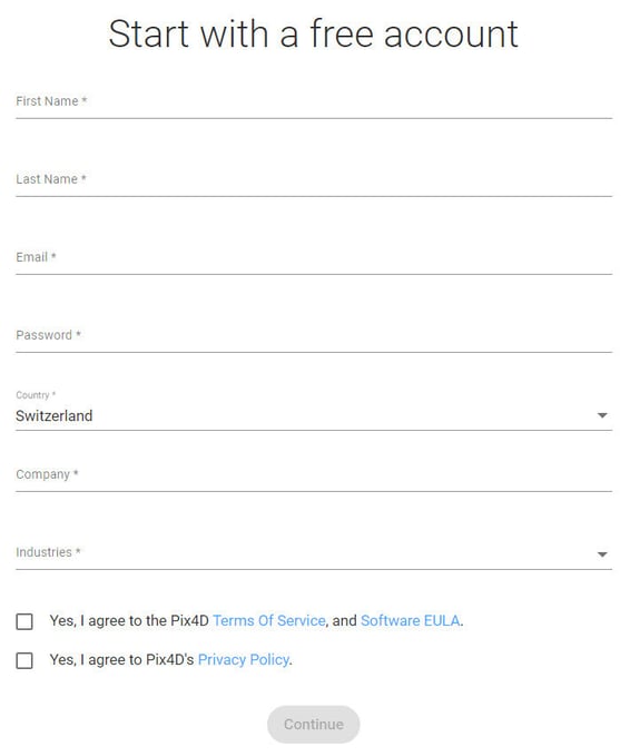

For new accounts, Sign up and create a Pix4D account. Once the Pix4D account is created, you can log in as described in the Log in section.
Sign up
To create a Pix4D user account:
1. Go to the sign up page.
2. Complete the sign up form.
3. Review and accept the Terms Of Service, and Software EULA.
4. Review and accept the Privacy Policy.
5. Click Continue.
6. Review the Privacy Settings.
7. Click Save.
Important: When the sign up is completed, click the activate account button in the email sent to the selected email address and start using Pix4D products.

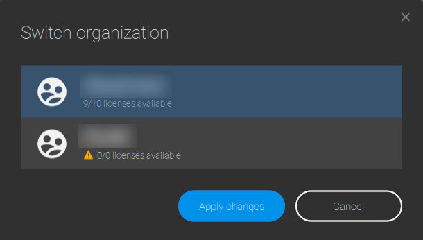

Organization
If the account used to log in is part of one or several organizations, it is possible to access the following options when clicking on the circle button containing the user account initials.
Organization PIX4Dsurvey
  • Organization settings: A direct link to access your organization settings.
  • Switch organization: Use this button to switch between organizations. A pop-up window will appear showing how many licenses are available for every organization that can be selected.
    Switch organization PIX4Dsurvey

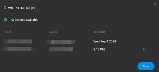

Device manager
Starting from the 1.67.0 version of PIX4survey a powerful feature aimed for enhanced license management has been added. It is now possible to monitor and control devices connected to the PIX4Dsurvey license.
How to Manage Devices
To manage connected devices:
  • Navigate to userAccount in the top right corner.
  • Click on monitor Device Manager:
    • The total number of available devices is listed.
    • A comprehensive list of all devices connected to the license will be displayed, including each device's name for easy identification.
  • Remote Deactivation: If needed, it is possible to free up a license seat by selecting the Reclaim Seat option for any device on the list, instantly deactivating the license on that device.
Note: The release of the seat may take a few minutes.
  • Click Done
