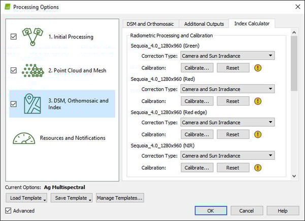

    1. On the menu bar click Process > Processing Options..., the pop-up Processing Options appears.
    2. Click 3. DSM, Orthomosaic and Index and select the tab Index Calculator.
    3. In the section Radiometric Processing and Calibration, the different available discrete bands are displayed. Under each band, click Calibrate...

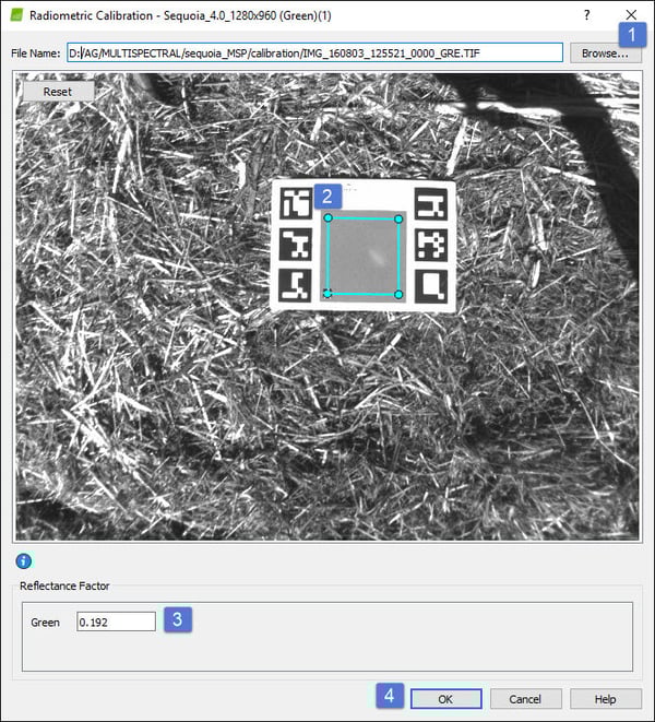

    2018-04-05_15-37-36.jpg Click Browse... to import the corresponding image of the calibration target for the selected band.
    2018-04-05_15-37-58.jpg Draw a region on the image that will define the radiometric calibration area, the region should be well inside the gray target and exclude all borders.
    2018-04-05_15-38-10.jpg Insert the Reflectance Factor value for the selected band. The Reflectance Factor value should be furnished by the target manufacturer. Only values between 0 and 1 will be accepted.
    2018-04-12_12-30-09.jpg Click OK. The camera is now calibrated for this band.
    4. Repeat the same procedure for each of the discrete band, click OK and run the project. Note that the radiometric calibration of the images is performed during Step 3. DSM, Orthomosaic and Index.

    Note: If a radiometric calibration target is used, it is recommended to make sure that the radiometric target data is taken into account by ensuring the symbol in the Processing Options is a green checkmark:
