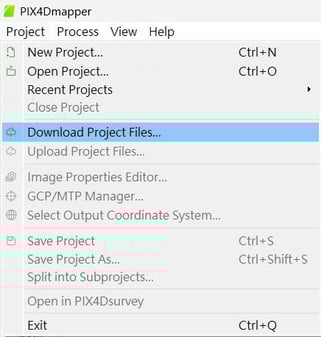

2. On the menu bar, click Project > Download Project Files...

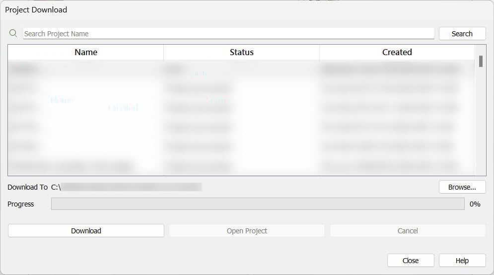

3. The Project Download pop-up appears:
4. The list of projects that have been uploaded appears under Name. Select a project.
5. (optional) Click Browse... to change the path where the project will be stored.
6. Click Download.
7. Click Open Project to open the project or Close to close the window as soon as the project is downloaded.
