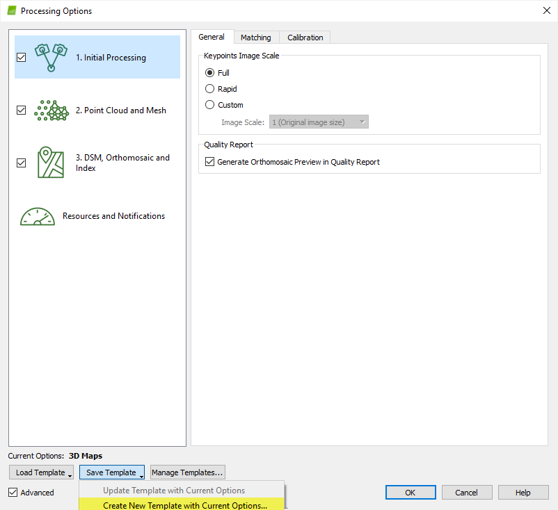

1. On the Menu bar, click Process > Processing Options...
2. Edit the options in order to fit the options of the new template: Menu Process > Processing Options....
3. Click Save Template.

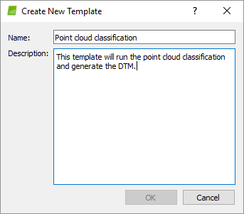

4. Select Create New Template with Current Options...
5. On the pop-up Create New Template, write the name and the description (optional) of the new template.
6. Click OK.
