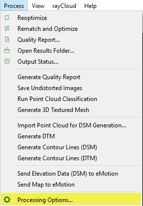

Access: On the Menu bar, click Process > Processing Options..., the pop-up Processing Options appears.

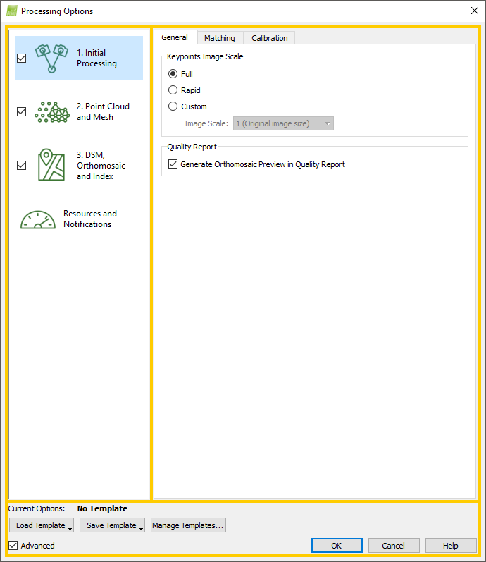

It contains three sections:
  • Processing steps and resources: Allows the user to select a step or the resources in order to visualize/edit options.
  • Tabs associated with the selected step or resources: Allows the user to visualize/edit the processing options, outputs and/or resources for the selected step/resource.
  • Processing options template: Allows the user to select a template, save a custom template and manage templates.
And four actions:
  • OK: Confirms the changes.
  • Cancel: Does not save the changes.
  • Help: Opens the PIX4Dmapper help.
  • Advanced options: Displays/hides the advanced options tabs, available for 1. Initial Processing and 2. Point Cloud and Mesh.
