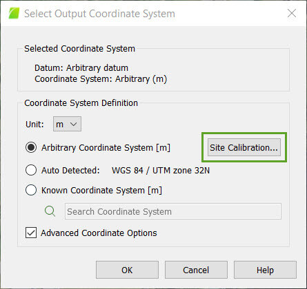

2. On the Menu bar, click Project > Select Output Coordinate System.
3. In the section Coordinate System Definition, click the Unit dropdown list to set the units of the coordinate system (meter [m] or international foot [ft]).
4. Select Arbitrary Coordinate System [unit].
5. Select the box Advanced Coordinate Options and click Site Calibration...

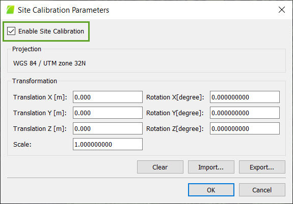

The pop-up Site Calibration Parameters appears. The section Projection defines the known coordinate system involved in the transformation.
6. On the pop-up Site Calibration Parameters, select Enable Site Calibration and click Import....
7. On the pop-up Select Import File, navigate to the file that has been previously exported. Select it and click Open. The site calibration transformation is loaded.
Note: The coordinate system transformation in the file should correspond to the transformation between the image geolocation and the arbitrary output coordinate system.
8. On the pop-up Site Calibration Parameters, click OK.
