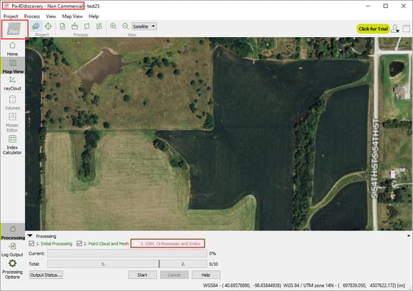

This article explains the "Step 3 processing is not available" error in PIX4Dmapper. This status does not allow the user to process the Digital Surface Model (DSM), the Orthomosaic, and the Indices. A message "non commercial" appears in the title bar.
Error
When logging into the PIX4Dmapper, the discovery mode is activated, instead of a paid or a trial license, even though there is a paid or a trial license assigned to the account. Step 3. DSM, Orthomosaic, and Index options is also grayed out. Within the Processing options, "not available with this edition" will be shown. The message "non commercial" appears in the title bar, and the logo has a gray color.
As a consequence, it is not possible to generate a Digital Surface model (DSM), an Orthomosaic, or the Indices. The DSM Orthomosaic and Index checkbox will not be available.

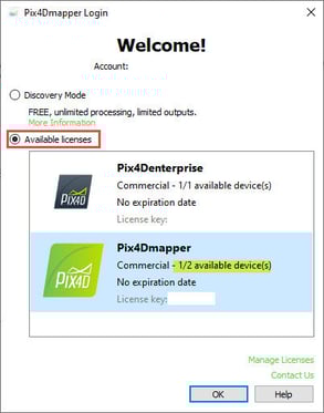

1. Log out of the Pix4D Discovery mode: How to log out of PIX4Dmapper.
2. Launch the PIX4Dmapper and login back. When logging in again, click on the Available license check box and then on the PIX4Dmapper license.
Note: If the number of available devices (s) is zero(0/1 or 0/2), remotely deactivate the device following the instructions here: How to remotely deactivate a device. If a remote deactivation of the devices is not possible, submit a request to deactivate the devices here.
