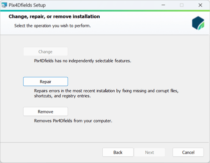

- Corrupted installation. It could be due to missing libraries or other file structure issues after updating to a new version. Please re-install PIX4Dfields:
- There is no need to uninstall the program.
- Download the installer from: https://account.pix4d.com/download-software.
- Double-click on the installer.
- Click Next.
- Select Repair and click Next.
- Click Repair.
- If re-installing does not solve the problem, information in the Registry Editor should be erased, please follow: How to uninstall PIX4Dfields.
