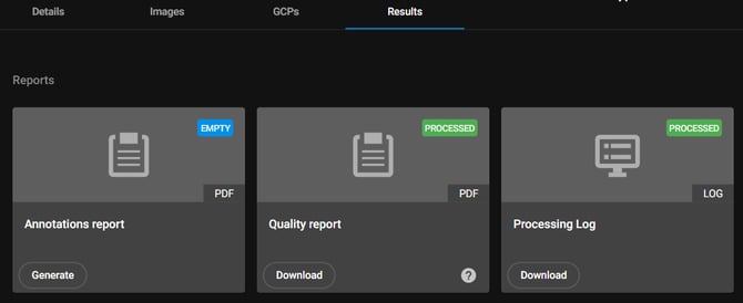

Access: The annotations report is accessible by clicking on the annotations report icon in the header which goes to Files & Export > Files & Reports > Results.

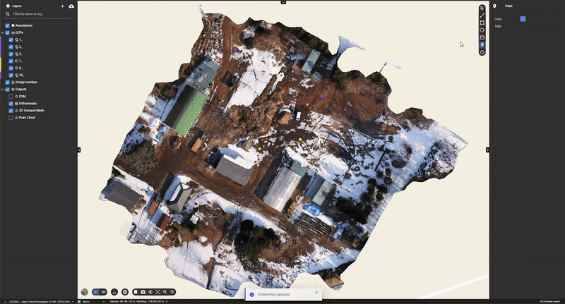

  1. Select the view in the 2D or 3D viewer

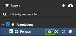

  2. Click on the camera icon to replace it ( in the right panel or in the hierarchy under the annotation layer)
    Screenshot_icon_right_panel_annotation_PIX4Dcloud.png Screenshot_icon_left_panel_annotation_PIX4Dcloud.png
  3. Confirm the changes.
modify_screenshot

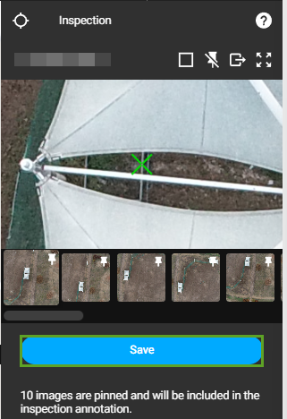

How to include an inspection in an annotations report.
  1. Click the virtual inspector icon to create an inspection.
  2. On the left panel, click Save.
    Note that the image that is shown in the annotations report is the first image selected by the virtual inspector feature.
Information: If more annotations are added or modified, a new report can be regenerated by clicking Generation from the Results tab.

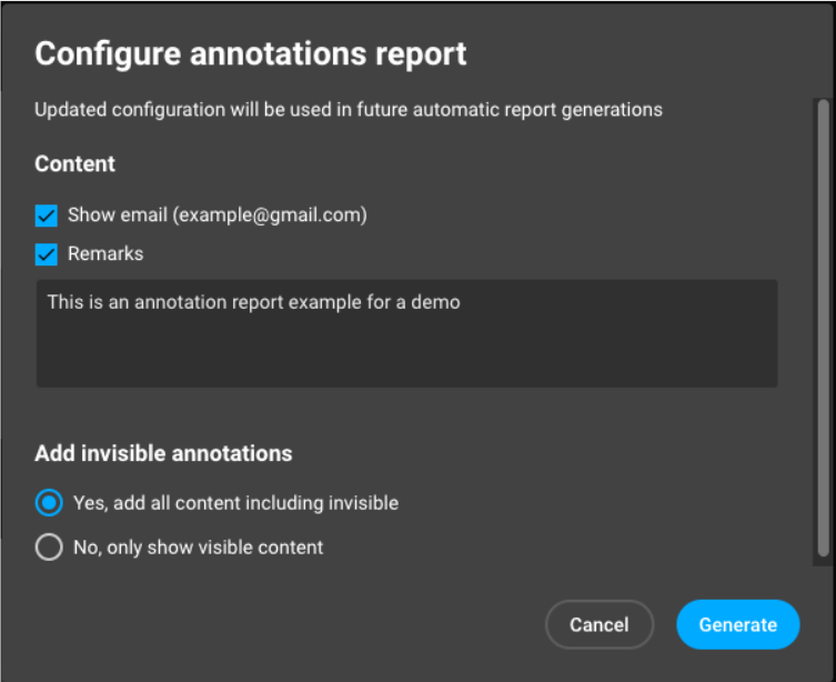

When a PDF annotation report is to be generated, the user can define which information is included in the first page:
  • User's email
  • Remarks
  • Include all annotations or only the visible ones.

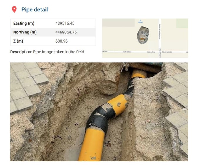

    • In greater detail, for each annotation, an enhanced cut-out of the annotation area together with the annotation’s properties (type, attributes and description).
    • An screenshot of the annotation on the right side of the properties.
    • (Optionally)An image attached from PIX4Dcatch below the properties and the automatic screenshot. image_annotationos
