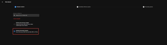

To upload results to a new dataset:
  1. Go to PIX4Dcloud and log in with a valid Pix4D account.
  2. Create a new dataset and follow the instructions to Upload processed results.

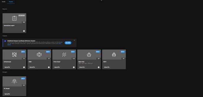

  3. In the Files & Exports > Files > Results section click Upload File in the box of the output to be uploaded, and browse for the directory to select the file. Alternatively, it is possible to drag and drop the file(s) onto the respective output section.
  4. The upload window pops up showing the upload status. Once successful, click CLOSE.

  3. In the Files & Exports > Files > Results section click Replace File in the box of the output to be uploaded, and browse for the directory to select the file. Alternatively, it is possible to drag and drop the file(s) onto the respective output section.
