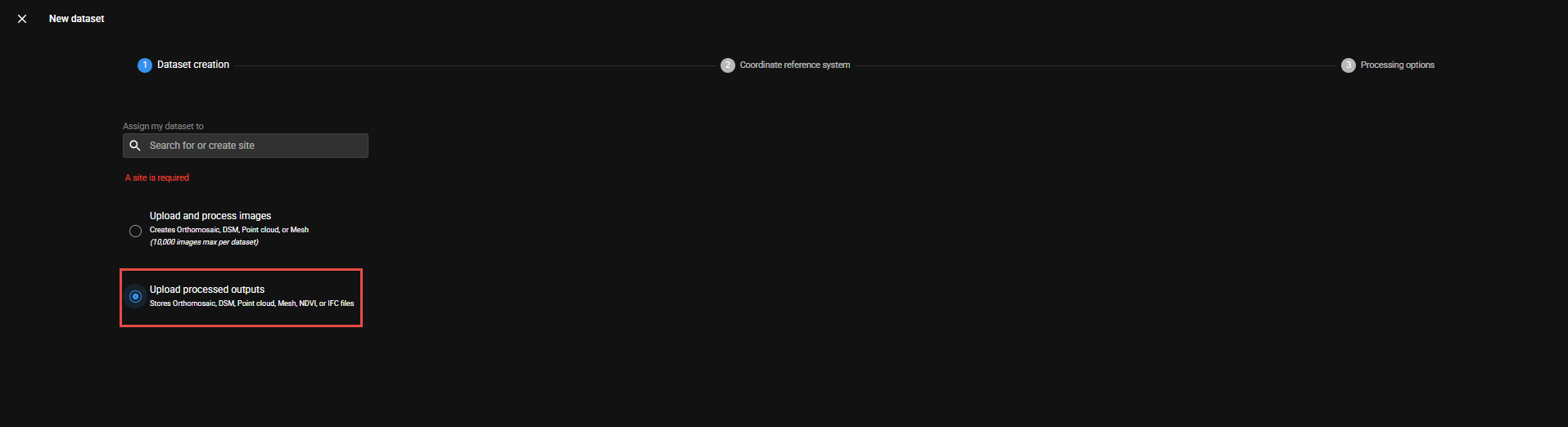

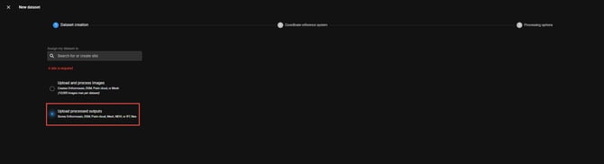

- Create a new dataset and select Upload processed results.

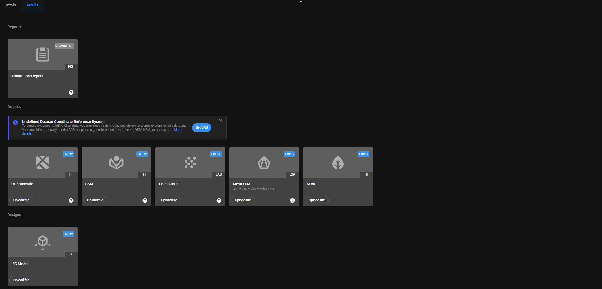

- In Files & Reports > Results, click Upload File for the corresponding output, or drag and drop the file(s) into the appropriate section.
- Monitor the upload progress in the upload window. Once completed, click CLOSE.

In Files & Reports > Results, click Replace File for the output to be updated, or drag and drop the file(s) into the corresponding section.
Wait for the upload to complete and click CLOSE.
