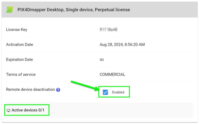

To enable the Remote device deactivation feature:
  1. Open PIX4Dmapper.
  2. Log out of PIX4Dmapper from all active devices. For more information see How to log out PIX4Dmapper.

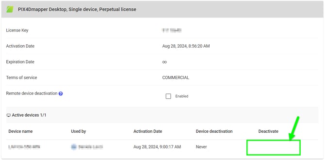

  3. Go to the Licenses panel.
  4. In the PIX4Dmapper license, next to the Remote device deactivation, click Enable now.
    PIX4Dmapper enable remote device deactivation
    Enabling remote device deactivation.
  5. Now launch PIX4Dmapper again.

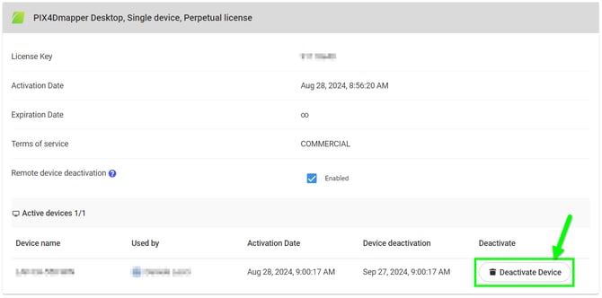

  1. Go to the Licenses panel.
  2. Identify the PIX4Dmapper license and the seat that needs deactivation.
  3. In the Active devices section, click DeactivatePIX4Dmapper deactivate button
    PIX4Dmapper deactivate device remote
    Deactivating a device from the license panel.
