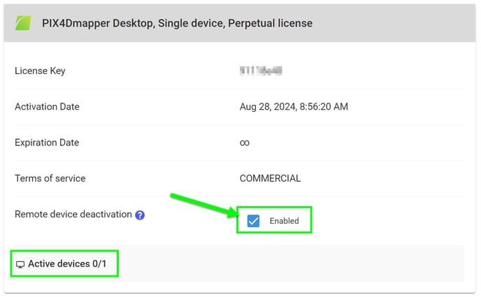

Important: Before enabling the Remote device deactivation feature, it is necessary to log out all active devices. Active devices will prevent the feature from being enabled.
To enable the Remote device deactivation feature:
  1. Open PIX4Dmapper.
  2. Log out of PIX4Dmapper from all active devices. For more information see How to log out PIX4Dmapper.
  3. Go to the Licenses panel.
  4. Select the organization where your license is located and click Continue.
  5. In the PIX4Dmapper license, next to the Remote device deactivation, click the checkbox Enabled (the number of active devices should be 0).
  6. Now launch PIX4Dmapper again.

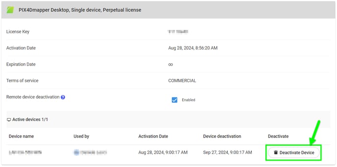

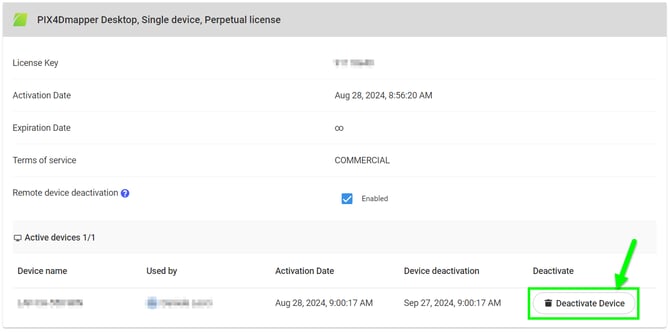

Once the Remote device deactivation feature is enabled, a device can be deactivated remotely as needed.
To remotely deactivate a computer:
  1. Go to the Licenses panel.
  2. Select the organization where your license is located and click Continue.
  3. Identify the PIX4Dmapper license and the seat that needs deactivation.
  4. In the Active devices section, click Deactivate Device .

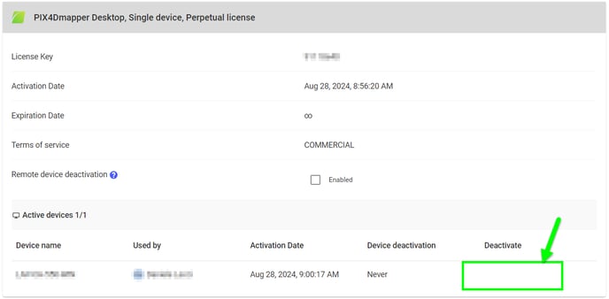

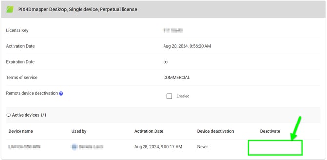

If the Deactivate device button  does not appear near your device in the Active devices list, and the Device deactivation is set to "Never" (screenshot below), it means that, most likely, the device was still active while the Remote device deactivation option has been enabled. Please log out from this device and enable the remote deactivation option again.
If access to the device is not available, the support team can manually deactivate it from the license. A support ticket should be opened here, ensuring that device deactivation is selected as the topic/product.
Important: After you get the device deactivated by the support team, please enable the remote device deactivation option. This action can only be done while you have no active device(s), so it is best to enable it before activating any new device. Doing so, it will allow you to remote deactivate a device without the need of asking the support team.
