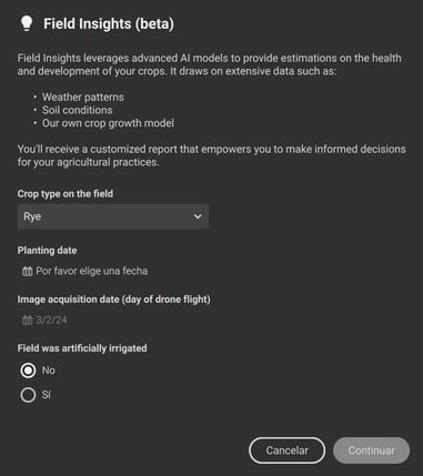

  3. The Field Insights menu appears:
    1. Select the crop type under analysis.
      Current supported crops are Rye, Corn, Winter Wheat, Potatoes, Winter Barley and Rapeseed.
      For other types of crops, please fill out our Feedback form.
    2. Select the Planting date.
    3. The Image acquisition date will be auto-populated for Satellite data and most drone orthomosaics. If not set, make sure that the Image acquisition date is after the Planting date
    4. Confirm if the field was irrigated artificially or not.
    5. Click Continue, and the report will be generated.

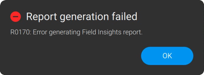

In case of problems, PIX4Dfields will show a message "R0170: Error generating Field Insights report."
R0170_PIX4Dfields
If you see this error, please try to change the planting date and try again.
If it still does not work, please contact technical support and provide us with the index layer and the exact used parameters (Crop, planting date, etc.).
