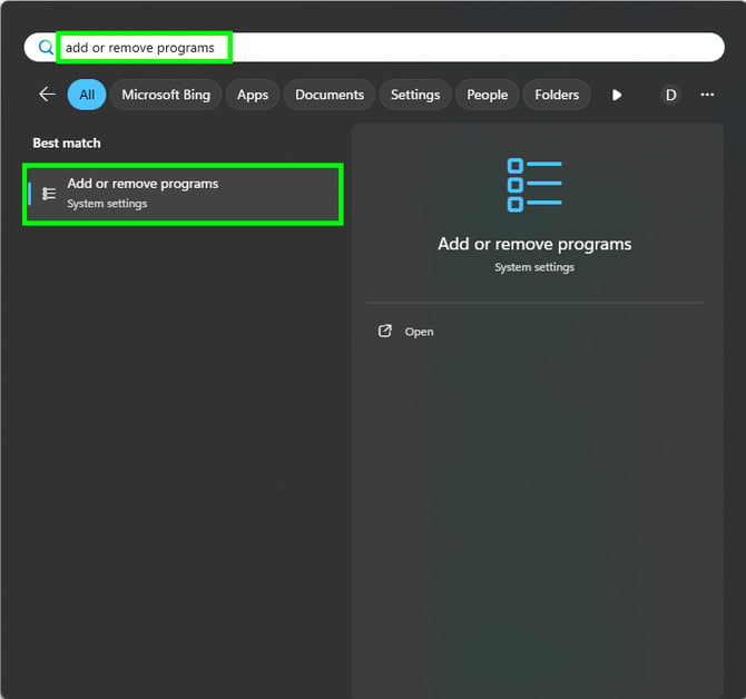

  1. In the Windows Search, type Add or remove programs.

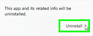

  3. Click Uninstall.
    Uninstall confirm

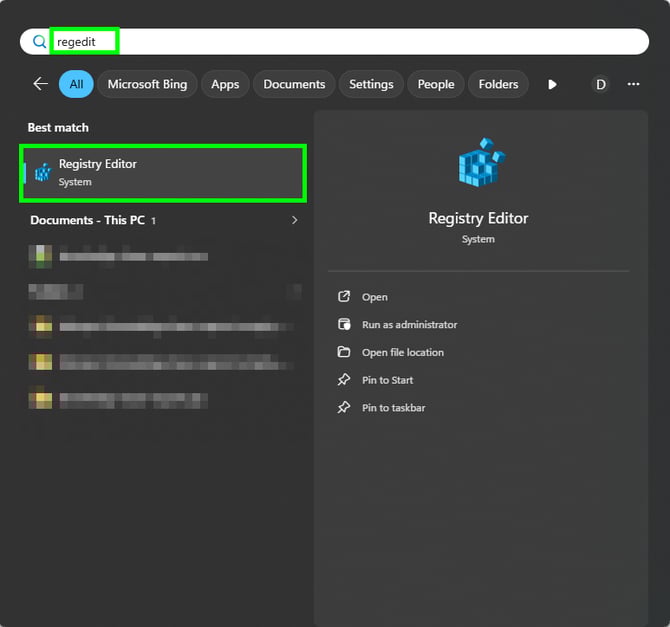

  7. In the Windows Search type RegEdit and open the Registry Editor.
    Regedit search

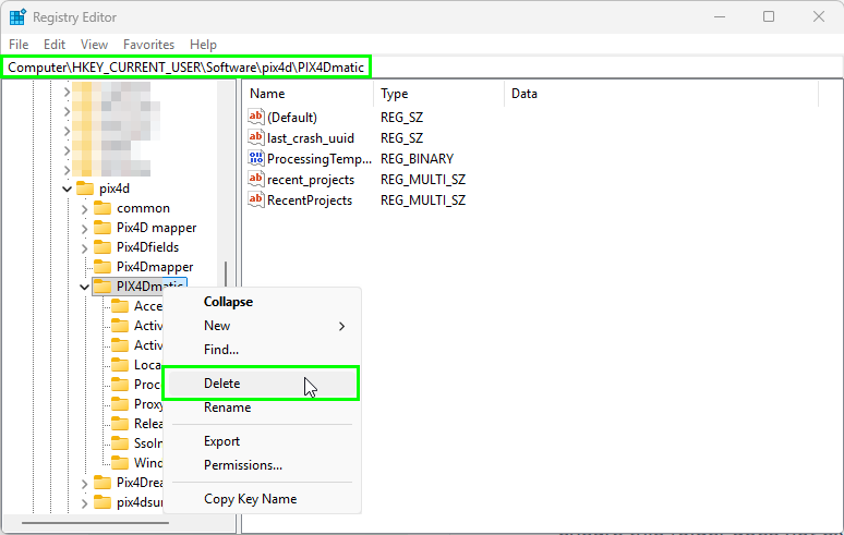

  8. Locate the folder stored in the path: HKEY_CURRENT_USER\Software\pix4d\pix4dmatic and ensure this folder does not exist anymore. If it exists, DELETE this PIX4Dmatic folder.
    Registry Editor Delete PIX4Dmatic
