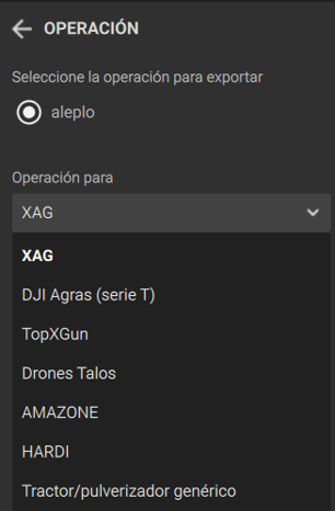

To export the Targeted Operation map:
- Go to Export, Operations.
- Select the operation layer to export.
- Select the brand and format:
