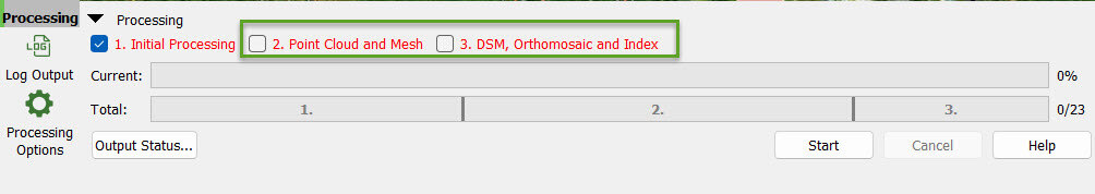

Confirm that steps 2 and 3 have been processed.
If steps 2 and 3 are shown in red, they need to be processed.
To process the missing steps, follow the instructions on How to process a single step - PIX4Dmapper.
