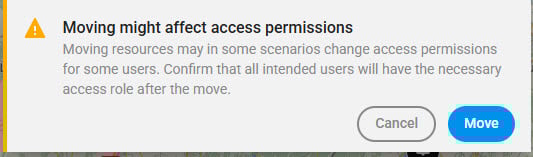

  • What Happens to Permissions After Transfer:
    • When a resource is moved within the same Organization, all users who had access keep their permissions in the new location.
    • Exception – Assigning a dataset to a Site:
      When a dataset is assigned to a Site, only users who have access to the Site will retain access to the dataset.

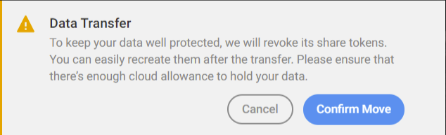

  • Existing shared links will no longer work after the transfer.

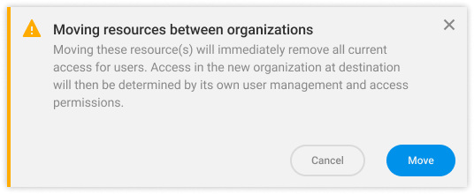

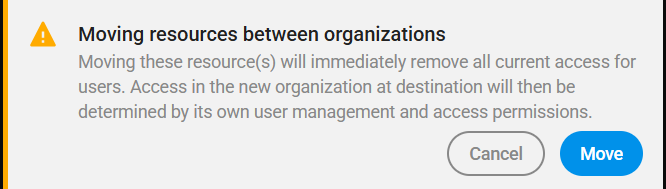

  7. Confirm the transfer when prompted.Notification Common
