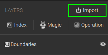

  6. Open Project B, and click Import:
    Import button
