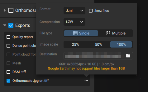

  3. Navigate to
    1. Processing options > Exports > Orthomosaic .jpg or .tiff and click on the More more_horizontal (1) button or
      kml

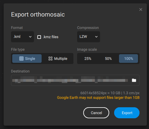

    2. ファイル > Export > Orthomosaic...
      kml_2
  4. Select .kml as Format.
  5. Select the desired File type, Compression, and Image Scale.
  6. Set the Destination path for the exported files.
  7. Click Export or Start.
