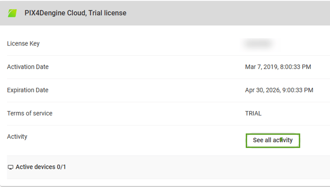

5. Under the ライセンス tab, search for the PIX4Dengine Cloud API  (for legacy licenses) or PIX4Dcloud Enterprise.
6. Click See all activity.
Engine Cloud API

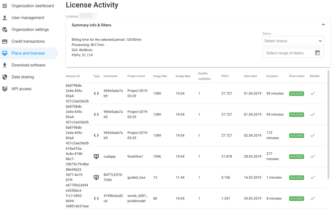

7. (Optional) It is possible to filter the processing activity list by:
  • Status: Success, Failure, Cancelled, or Crash
  • Month
  • Year
Example: If Status: Success, Month: 1, and Year 2022 are selected, then the activity list will display all the successful projects of January 2022.
