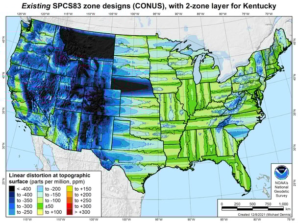

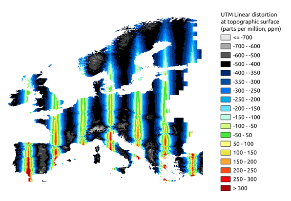

For example, the two images below provide a visual representation of linear distortion in the US and Europe (Source: National Geodetic Survey).
