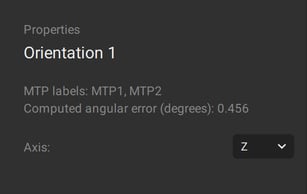

Properties panel
The Properties panel displays the axis of the Orientation constraint along with the computed angular error in degrees. When a new Orientation constraint is created, the correct axis (X, Y, or Z) information must be entered in the Properties panel.
Orientation constraint properties

  1. Select the axis (X, Y or Z) in the Properties panel.
