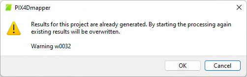

This article explains what the "Warning w0032: Results for this project are already generated. By starting the processing again existing results will be overwritten” message means in PIX4Dmapper, why it appears, and how to fix the most common causes yourself.
If warning w0032 appears in a pop-up message after starting a processing, it means that at least one result already exist and will be overwritten.
w0032-1
Warning description and causes
When starting a processing you may see the warning w0032.
Typical cause is the processing step selected that will produce an output that is already existing, usually form a previous processing.
Note: This message is a warning and not an error. It does not prevent processing. However, this warns the user of a possible loss of data.
Solutions
This warning message is expected and informs the user that proceeding will overwrite the existing results.
  • To overwrite existing results:
    • Click Ok. PIX4Dmapper will overwrite the existing results and keep the last version processed
  • To keep existing results:
    • Click Cancel.
    • Go to Project > Save Project As... This will create a copy of your project
    • Process using the project that you just created. The results from the original projects will not be affected
