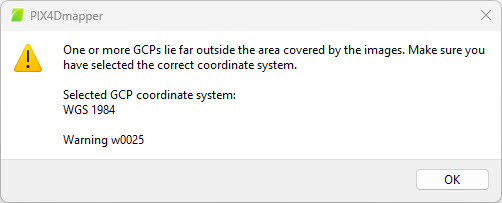

If warning w0024 or w0025 appears in the PIX4Dmapper log file or as a pop-up message, it means that at least one Ground Control Point (GCP) is far from the project area (defined by the location of the images).
w0025
Warning description
When importing Ground Control Points (GCPs) into a PIX4Dmapper project, you may see the following warning messages:
  • w0024: One or more GCPs lie far outside the area covered by the images. Check if the correct GCP file and coordinate system are selected
  • w0025: One or more GCPs lie far outside the area covered by the images. Make sure you have selected the correct coordinate system (followed by the selected GCP coordinate system)

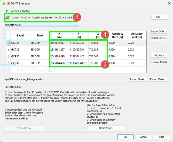

    1. In PIX4Dmapper, open the GCP/MTP Manager.
      • Menu Project > GCP/MTP Manager... or
      • Click the GCP/MTP Manager button
        GCP/MTP Manager
    2. Make sure the values in the GCP/MTP Table are correctly imported and there are no misspellings.
    3. Ensure that the GCP Coordinate System is correctly set and matches the one used by the surveyor when acquiring the GCPs coordinates.
    4. Also, make sure to provide the coordinates according to the unit of the selected Coordinate Reference System. These can be in meters, feet, or degrees. The unit is given in the first row of the table. If the coordinate values in the GCP/MTP table (2) do not match the unit shown in the header (4), this indicates that the wrong GCP Coordinate System (3) has been selected. For example, if the GCP values are in the format 46.34293815, 8.02197940 (indicating degrees) but the header shows [m], the GCPs will appear far from the project area. The correct GCP Coordinate System (in degrees) will need to be selected.
      GCP/MTP Manager window in PIX4Dmapper

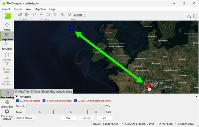

      Identify Axis Swap
      1. In PIX4Dmapper, open the Map View.
      2. Zoom out in order to see the images (red dots) and GCPs (blue crosses). If these are on the same latitude, jump this section and go to the next section.
        Otherwise, the images and GCPs will appear quite far away from each other.
        PIX4Dmapper map view with GCPs and Images geolocations

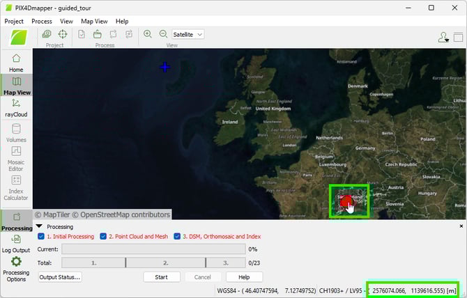

      3. Hover on the images and annotate the coordinate shown in the bottom/right corner
        Hover the mouse over the images and check the coordinates

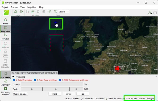

      4. Hover on the GCPs and note the coordinates.
        Hover the mouse over the GCPs and check the coordinates
      5. If these are the same (similar) coordinates as the ones shown on point 3, but with the order swapped, then the axes have been swapped during import. Please import the geolocation again in the GCP/MTP manager, making sure to select the correct coordinate order.

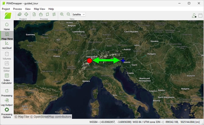

      Wrong longitude (correct latitude)
      2. Zoom out in order to see your images (red dots) and GCPs (blue crosses).
      3. If the blue crosses and the red images are at the same latitude (north or south) but on a different longitude, it is likely that the coordinate system is using a UTM zone and the wrong zone has been selected.
        In this example, WGS 84 / UTM Zone 33N has been wrongly selected instead of WGS 84 / UTM Zone 32N.
        Map view with images and GCPs on the same latitude
      4. Select the correct UTM zone in the GCPs coordinate system.
