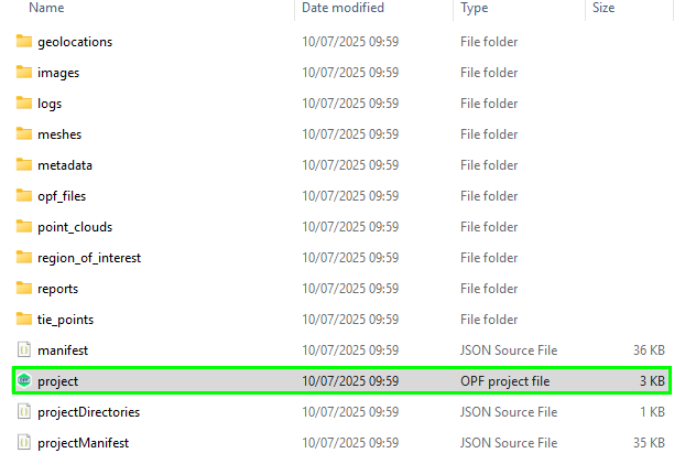

project.opf file in File Explorer

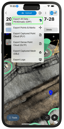

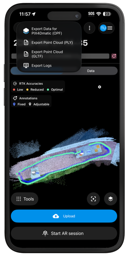

  1. On the PIX4Dcatch home screen, tap Project at the bottom.
  2. Select the project for export.
  3. Tap Export export icon in the top-right corner.
  4. Select Export All Data - PIX4Dmatic (OPF) maticlogo.
     PIX4Dcatch export data for PIX4Dmatic OPF

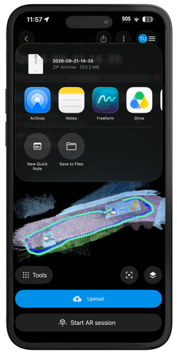

  5. Choose the export method (e.g, email, cloud storage, phone storage).
    PIX4Dcatch export data for PIX4Dmatic OPF select method
  6. A .zip file will be generated containing the project folder.

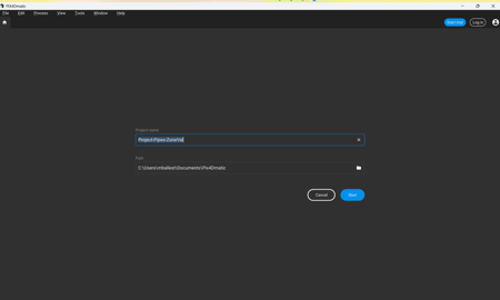

  3. PIX4Dmatic will launch it automatically and display the project name and file path, which can be edited if necessary.
    Matic launch
  4. Click Start.

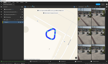

  5. PIX4Dmatic opens with the OPF content.

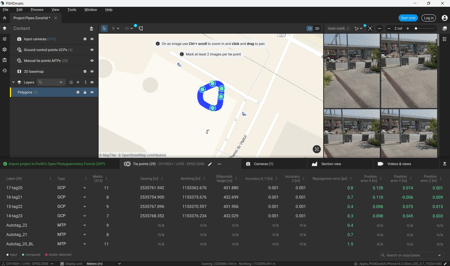

  6. The Tie Points tab will display the imported Ground Control Points (GCPs) and Manual Tie Points (MTPs).

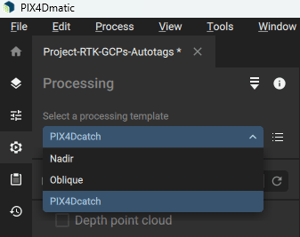

       7. Select the processing template called PIX4Dcatch.
            PIX4Dcatch processing template
Note: As of PIX4Dmatic version 1.79.0, PIX4Dcatch template is selected automatically.

  4. The project folder name and path will be displayed and can be edited if necessary.
  5. Click Start.
  6. The OPF content will appear in both the Content tab and the Tie Points tab.

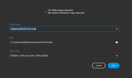

  4. Confirm the project name, path, and coordinate reference system (CRS).
    matic_start_view
  5. Click Start.
  6. The OPF content will automatically appear in both the Content tab and the Tie Points tab.
