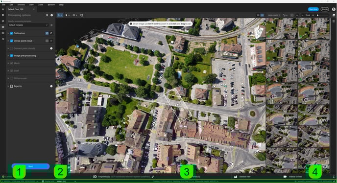

The Status bar is located at the bottom of a PIX4Dmatic project and is divided in 4 different sections:
  • [1] Project's coordinate reference system
  • [2] Display unit
  • [3] Pointer position
  • [4] Camera information
Status bar in PIX4Dmatic
