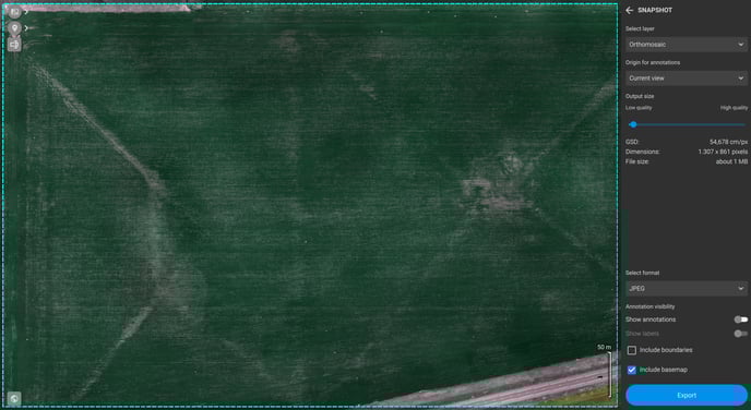

The snapshots feature allows for quickly obtaining a high-quality image of the map view.
To access the feature:
  1. Go to Export, Snapshot.
  2. Select the layer to be included in the snapshot.
  3. Configure the rest of the settings accordingly.
  4. Click Export.
    snapshot example
  5. After exporting, the image will be created, containing a scale bar located at the bottom left as a reference to distances.
