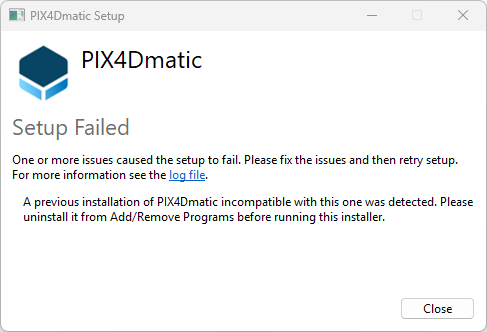

When a PIX4Dmatic version 2.2 (or older) is already installed on a Windows computer, the installation of PIX4Dmatic version 2.3 (or newer) leads to a "Setup failed" error.
PIX4Dmatic Setup Failed
Solution
To resolve this issue, first manually uninstall any older version of PIX4Dmatic (version 2.2 or earlier). Then, install the latest version of PIX4Dmatic.

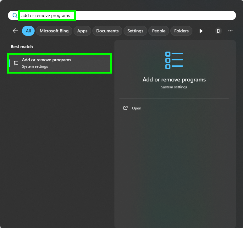

    1. In the Windows Search, type Add or remove programs.

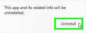

    2. Scroll to find PIX4Dmatic and click the three dots and then uninstall.
      Uninstall button
    3. Click Uninstall.
      Uninstall confirm
