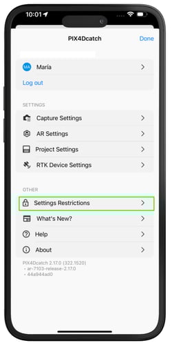

  1. Open the Account menu.
  2. Tap the Settings Restrictions.
           3. Review the available settings and toggle those to be blocked.

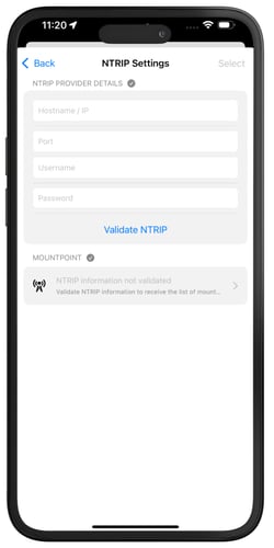

    • Hide NTRIP CRS Selection: Prevents selection of the Input Coordinate Reference System in the NTRIP settings. The field will be hidden.

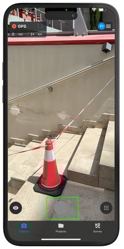

    • Block Capture without RTK: Disables capturing when GPS is selected. The capture button will be unavailable until RTK is active and connected to an NTRIP service.
    • Block Captures without RTK-Fixed: When enabled, the capture button is available only when RTK is FIXED.

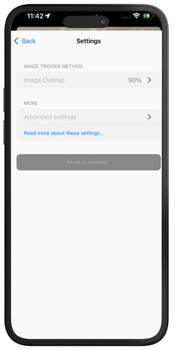

    • Block Capture Settings: Allows the Manager to define the image trigger method and advanced capture settings for projects. Other users cannot change any capture-related settings.

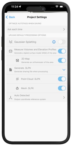

    • Block Project Settings: Prevents changes to project-level options such as optimizing autotags on save or default processing options for uploads.
